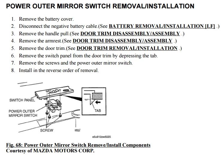

Do i just pop it off?

Thanks both, do you guys know how the switch comes off i can spray it? Cant find anything about it anywhere!
There are some MX-5 factory Service Manuals available at web.archive.org.
