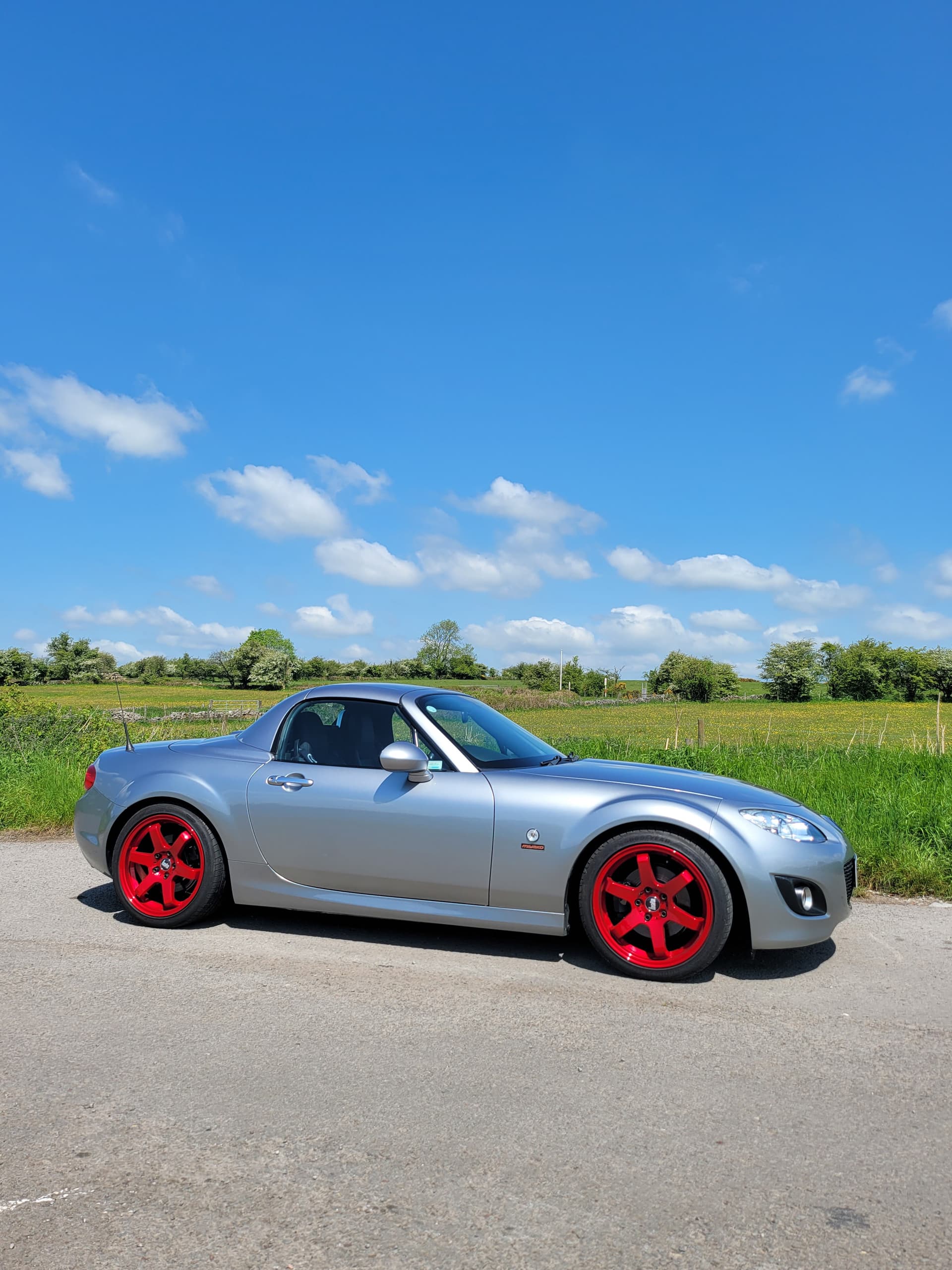

Here’s another with the Roddisons treatment.
Meister Sportives, manifold changed and mapped to 180bhp.

Stunning! I like it a lot. I recognise the car and wheels (Bola B1). It used to belong to someone on here. The Meisters are virtually brand new - same for wheels and tyres.
I have a soft top in the same colour as your car - Aluminium. The colour combination of you car and wheels may split opinion but I personally love it… very jealous.
I would be interested to hear your opinion on the Meisters - most people rave about them. I am having a few suspension related issues and will probably be swapping over to Meisters, in the near future.
Lastly, has anybody mentioned rust, yet… I’ll get me coat.
Glad you like her. She’s absolutely immaculate with an interior literally like new, below average mileage, rust proofed underneath and pretty much rust free other than a tiny bit round the boot light which I’m having done on June 19th. She’s been very carefully maintained. The Bola wheels have grown on me and I now really like them, though I’m going to change the Goodyear tyres she’s shod with as they are very noisy with the hood up and anyway I prefer Yoko ADO8RS tyres which I’ll be getting the week after next. I’ll put the Goodyears on the original silver Miyako wheels I was given with the car and perhaps use them in the winter.
Before I bought this one I tried quite a few out and frankly was a bit underwhelmed by the handling and was going to get Meister R coilovers if the car I bought didn’t have them. Luckily for me this one already had had them fitted, though not the Club Race that I would have preferred. However, I’m absolutely staggered by the difference the Meisters have made. Completely changed the handling and now I prefer it to my Caterham 7. I’ve taken them to full hard which means she’s a bit jiggly round town and on bad roads but on the local B roads I drive a lot, she’s really pointy, very flat round quick corners and I have full confidence in how she handles. To the point I’m finding I’m taking corners much faster than in my 7. And that’s a real testament to the difference the Meisters have made. I could not recommend them more highly and I would say putting these guys on should be at the very top of everyone’s todo list when they buy an MX5. If you’re thinking about it now, don’t think any longer. Get on the phone and order them. I can guarantee there won’t be one second of regret.

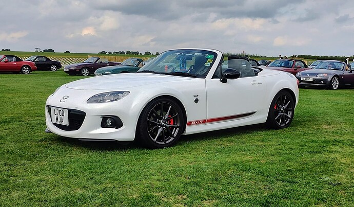

Very nice. I had hoped to find a white one too as they look brilliant in white. However, the one I bought was in such good condition, and with the coilovers I couldn’t turn it down.
