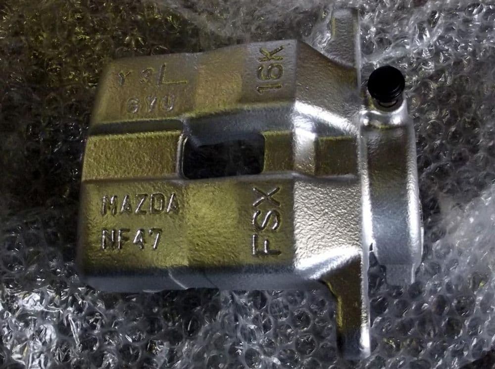

Hi, front brake callipers on my mx5 2.0 sport 2010 are a bit of a mess, I changed brake pads recently (first time doing this myself - slowly trying to learn how to do these things for myself) and noticed the piston seals are split as well as the seals for slider pin and the callipers are a bit of a mess in general so I’m planning to remove them completely and send off to be fully refurbed.
I did have a totally newbie question however about the the brake lines and fluid… what is the best way to deal with the brake fluid when disconnecting the line from the calliper to remove the calliper to then send them off? They’ll be disconnected for about a week until I get them back. The lines are braided stainless steel if that matters (I saw one YouTube video where someone was clamping the line to quickly change over, but thought that may damage the line…)

Check out Autolink, they have refurbed (Mazda) calipers ready. Buy your caliper and return the old one within 60 days, refunded surcharge on returning.
You then have a caliper ready to fit when removing the old.
