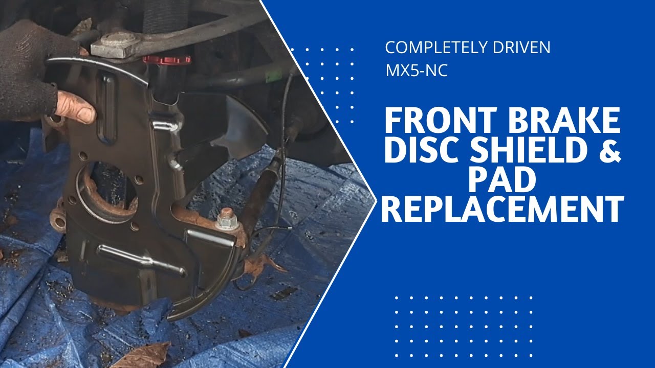

Got this job on the to do list for my NC. Dust shields on back order with mx5parts, due anytime now.
Never done it myself but it seems a pig to remove the hubs, need some sort of puller or home made device. Remove the sensor from the rear first (one bolt) then the four securing bolts. Then it’s parting of the hub time.
I take it you want the fronts replacing.
I’ll probably try the 2nd device down shown in these two clips here…
Hi Mick,
Many thanks for the reply and the U Tube videos, really useful.
Cheers,
Dave
