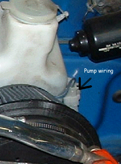

On a 1990 Roadster there is no low level warning on the windscreen washer bottle
 Hi Geoff - There certainly is on mine. Will empty the water out and see what lights up.
Regards
Rod
Are you sure you’re not seeing the wires running to the washer pump, not an electronic warning?
Jack.
 Err Sorry - Should know better than to argue with my betters.
Embarassed
Rod
Not betters mate, just been around these Mk1s a long time
