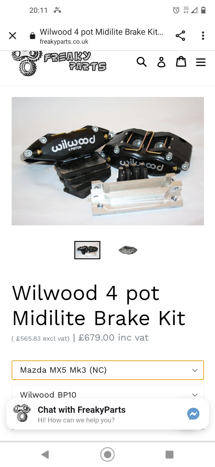

Spotted these online, (hope image has attached)
