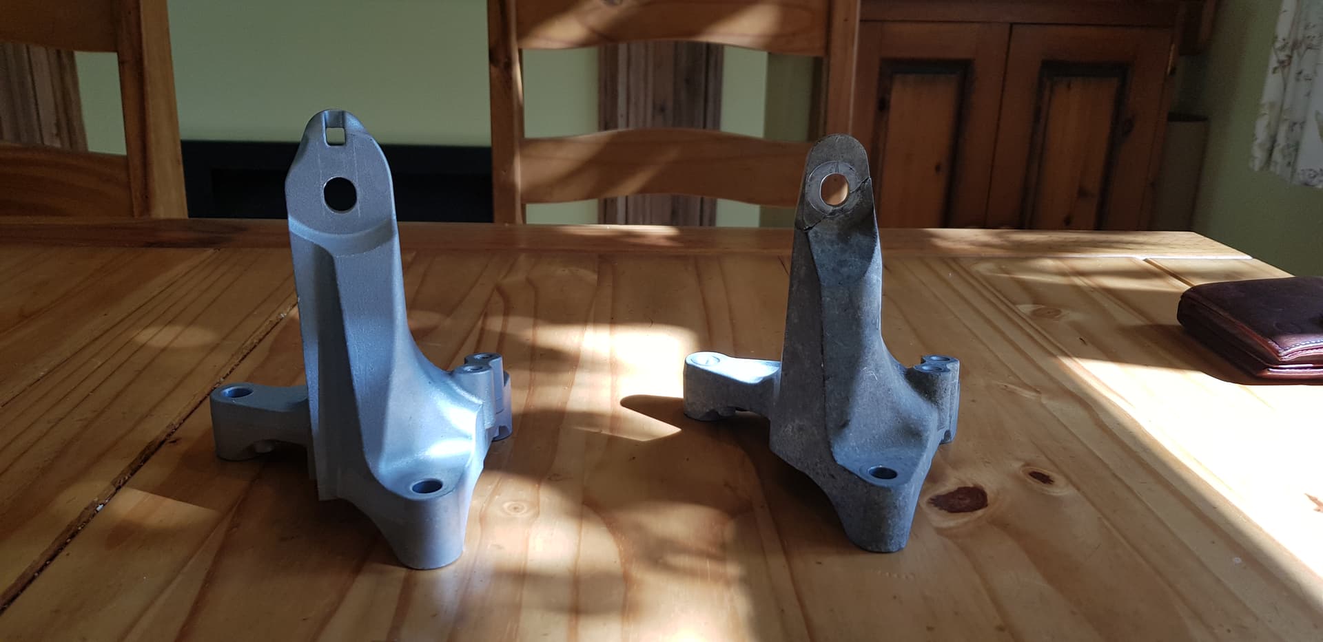

Broken ND Engine Bearer
I noticed on my recently bought 2016 ND that the engine felt rough when starting and there was some vibration felt through the gear lever. At first I thought it was a dodgy plug but on looking carefully I discovered that the LH engine bearer had cracked through the hole for the rubber mounting and the engine had moved about 5 mm to the off side of the car. I think this happened whilst cornering a little briskly round a sharp bend.
Northampton Madza supplied a new bearer on next day delivery and I noticed it was a modified part with thicker material around the mounting hole. Perhaps this had been a known problem. Fortunately fitting it was straightforward although slightly fiddly. Has anyone else had this break?

I’m rather impressed that following a “fiddly” removal you had the inclination to put the old and new parts, on what looks like quite a nice table, to photograph them.

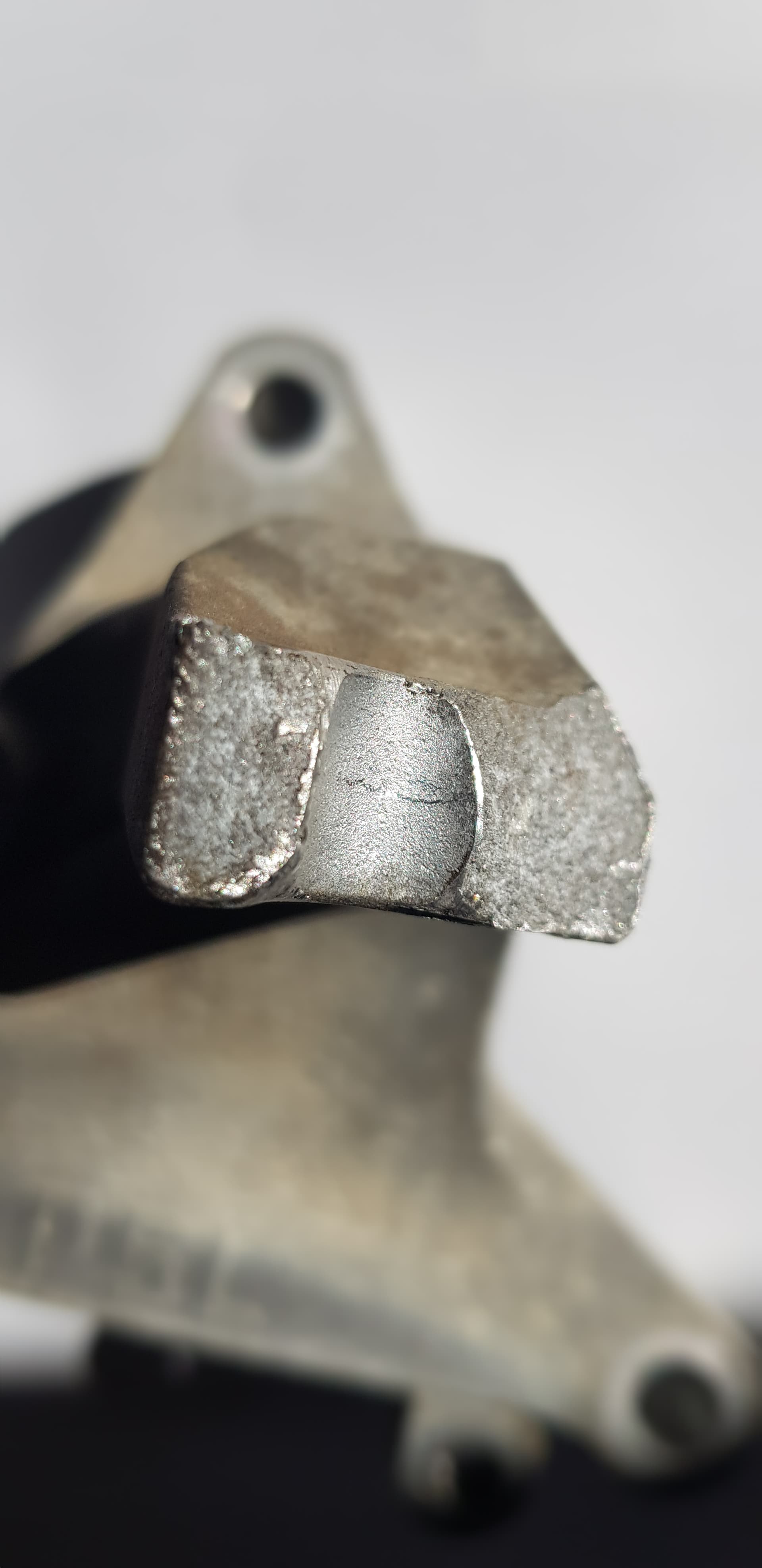

Hmm, it’s difficult to tell from a single photo, but the fracture seems to run across between the ends of the webs.
Some speculation then based on unfortunate past experiences. I hope I’m wrong.
I assume it is an alloy casting, because if it was steel the innate elasticity would have helped it survive vibration much, much longer, perhaps indefinitely.
If the webs went fully past the bolt hole then it becomes more rigid, less flex, and thus has significantly longer life.
The new version seems to have the same uniform thinness right across the bolt zone.
So in the absence of extended side webs to stiffen it past the bolt hole, I expect it will fail as well.
This time the crack might go around that sharp cut-away curve at the end of the thick part.
Except it will be after a bit more time because of less flex in a bit more metal.

Hello Richard, The car had been in a minor bump that set off the DHS but not caused any structural damage or set off any other air bags so I was happy to buy it as a Cat N to replace my NB. ÂŁ4700 for a 2016 Sport Nav 1.5 was too much of a bargain to be missed! The bearer is an alloy die casting and the break seems to be a clean fracture. I had driven the car about 1000 miles since putting it back on the road and am certain the break occurred after some tight bumpy bends in Wales. At 47,000 miles the car drives beautifully and I am delighted with it.

Hmm, the alloy seems quite a coarse grain, what we used to call “muckite” at work.
The break looks like a clean one-shot pull, not so much a flex fracture. It might have started on one side of the bolt-hole in that minor shunt but been held together by the bolt’s clamping action, then finally shaken loose by your Welsh enjoyment.
But please ignore my idle speculation. I’m well out of date on modern metallurgy.
