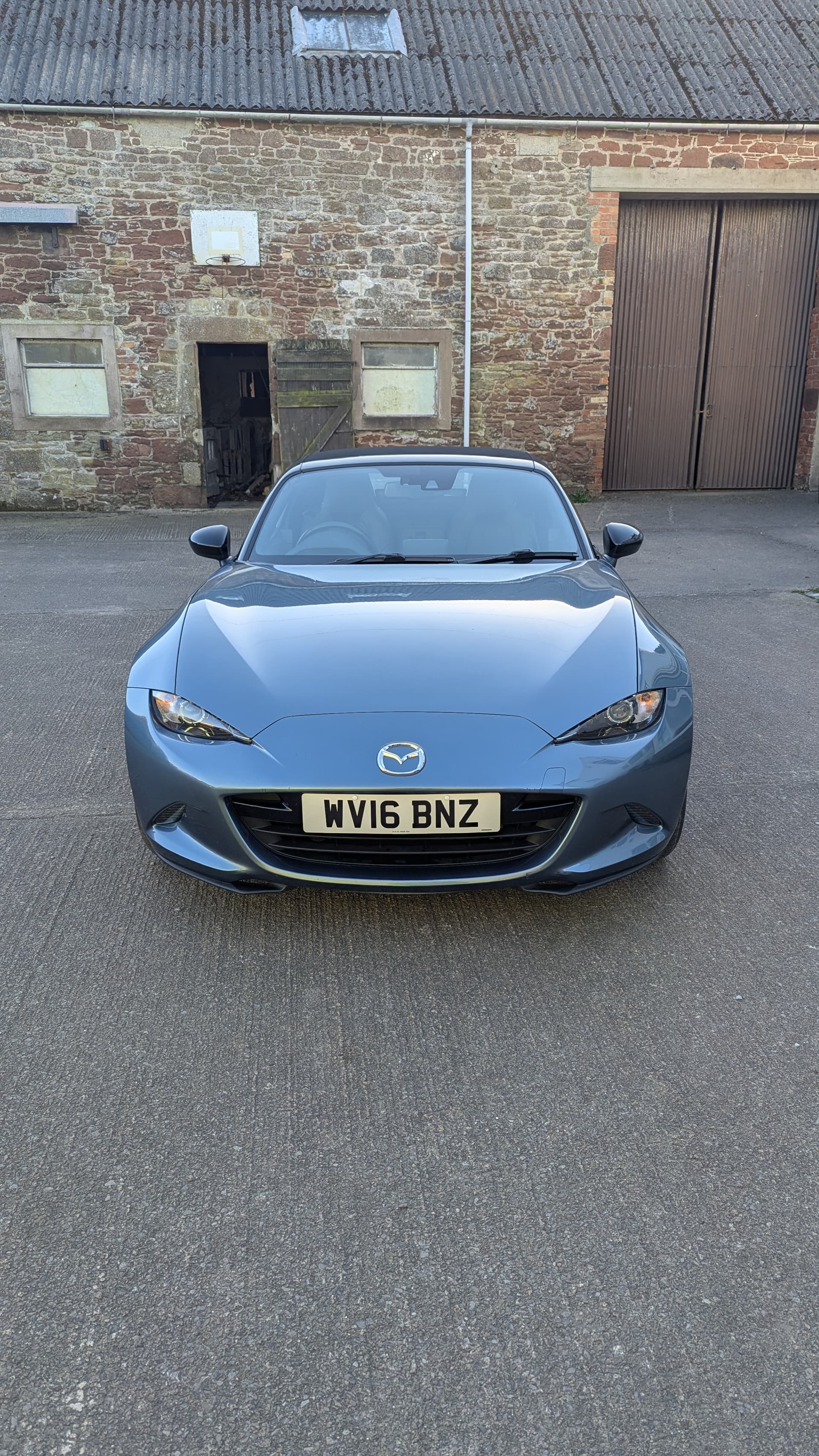

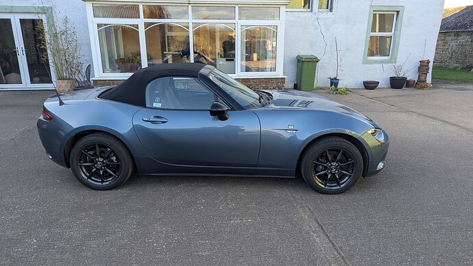

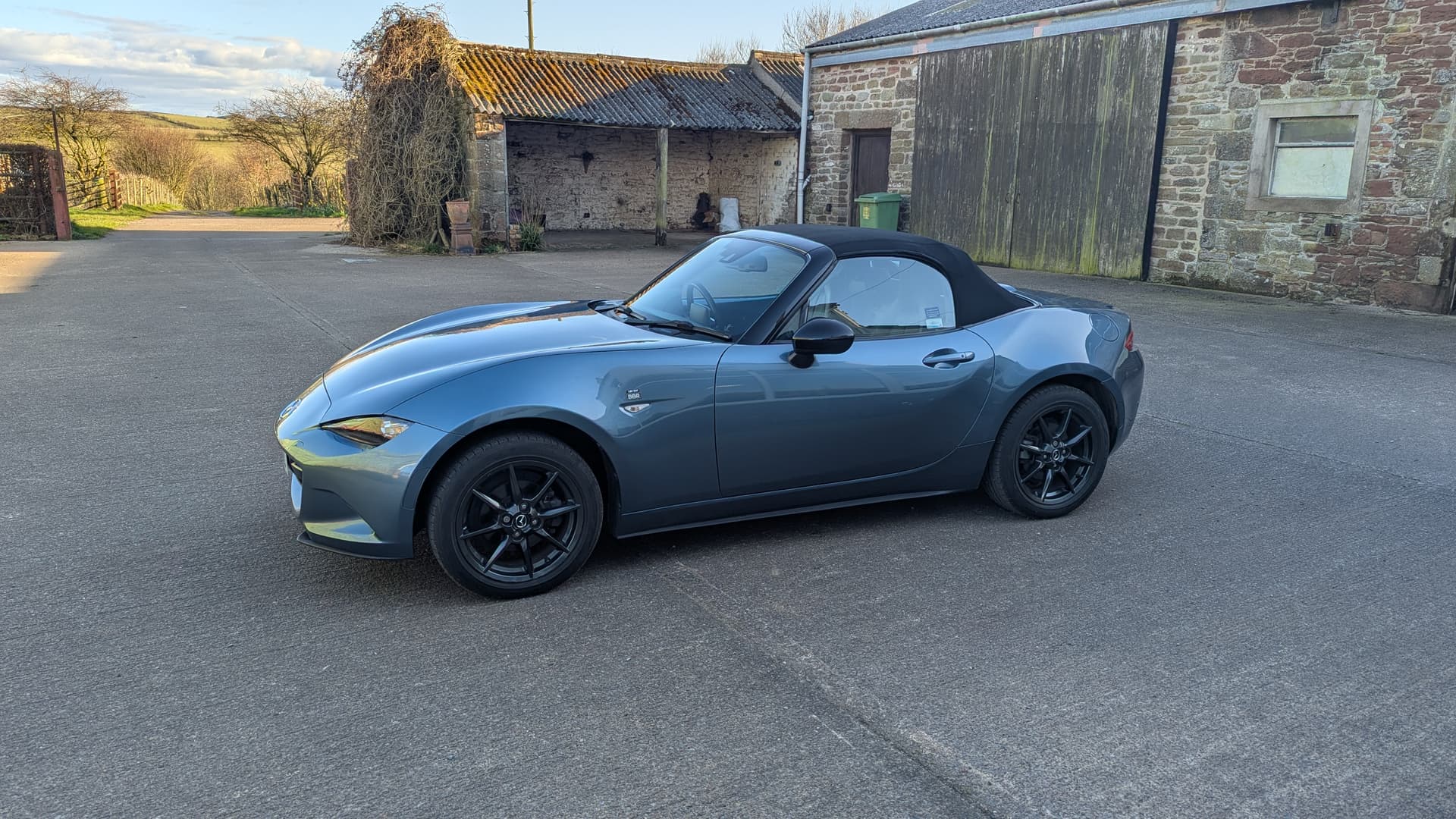

Some images of the car from where I picked it up and a very scenic view from a service station on the way home, very unlike the ones in the south!
Congratulations.

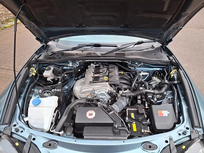

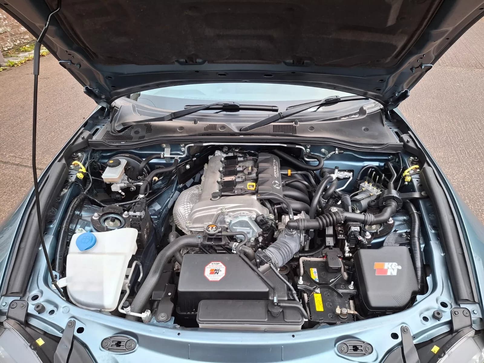

Looks very nice. What BBR bits does it have, given the wing stickers attached?
That’s a good point. I emailed BBR to check with them and they have no record of having worked on this car, but suggested it might have been chipped or possibly have some of their exhaust parts or manifold on it. They also mentioned they do not do a 180 BHP kit for this car.
I currently don’t know enough about what the standard setup would look like to check. It would be nice to think it has been breathed on but it may well just be the stickers!
Picture included for the eagle eyed to spot any differences!
Looks very nice and clean under the bonnet which is always a good sign of a conscientious owner. I would take the wheels off and have a good look at pads, discs and clean dirt off the suspension and wheel arches. When the wheels are back on check for any brake drag. A wash and polish is always a good way to inspect the body. If necessary an oil and filter change. By then you will have a gut feel for the car so can enjoy driving it.
