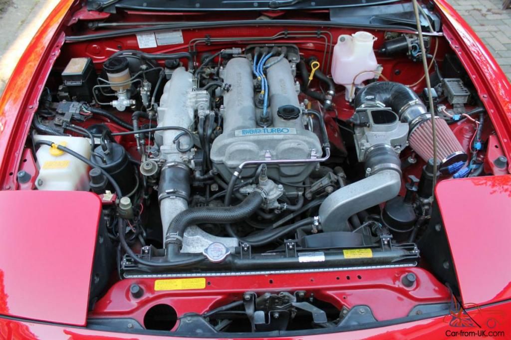

Original fitment is a chargecooler (water/air), not an intercooler (air/air). Otherwise as above
This may help
It most certainly is not a water to air chargecooler!
I have a BBR conversion and the dealer fitting instructions!
The original intercooler (air to air) fits behind the rad like that pic and therefore is inefficient.  There is no link to any water Cooling system, just 3 brackets to the rad. Many owners either fit a half width Honda Civic rad like I have, or fit an entirely new replacement located in front of the rad.
