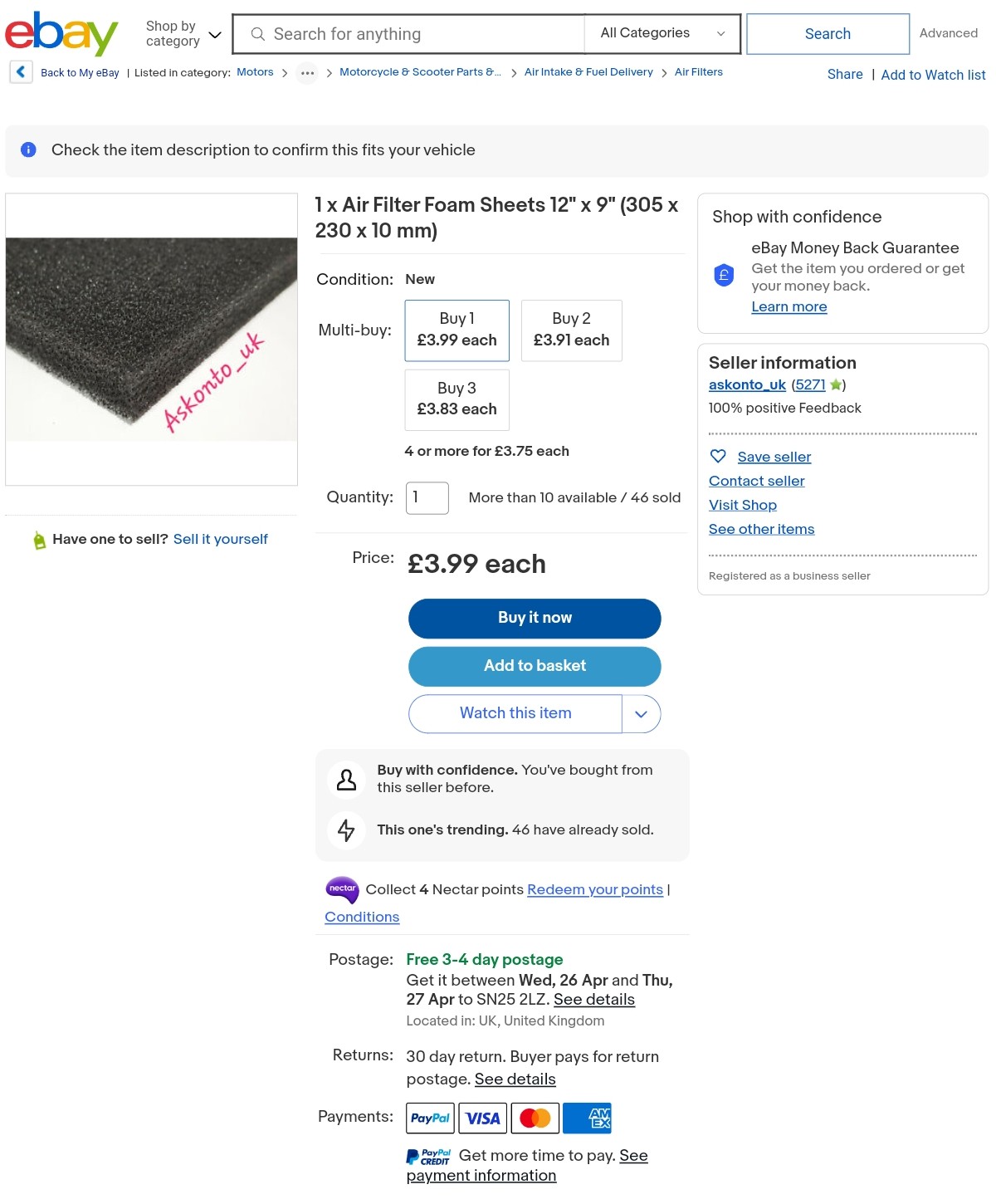

This is the foam i used
Great! Thanks. It seems to be more common in the UK, but there is some on the German Ebay and Amazon sites.
