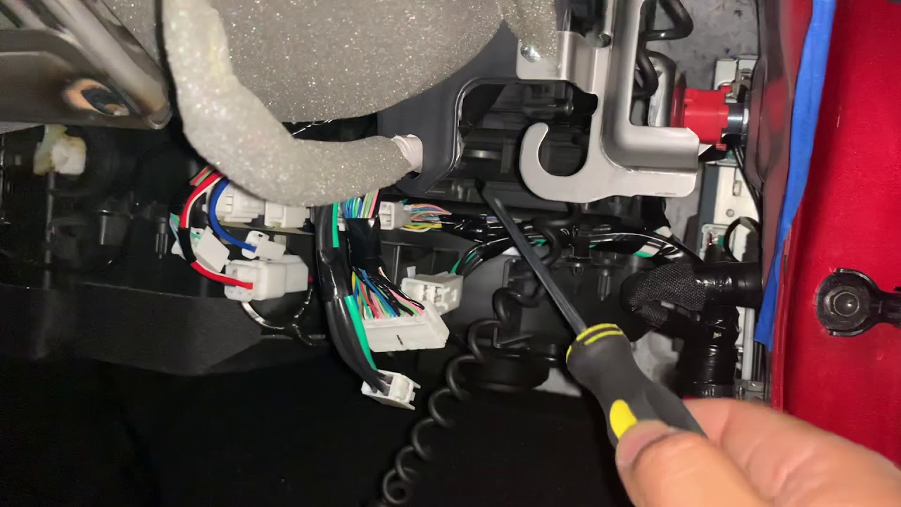

Hi MickAP,
I wondered after seeing this on YouTube.
Ofiaich
That’s not a cabin filter just a square of mesh, presumably to catch any bits of debris that may enter the system.
You wouldn’t be going to those lengths to replace that, it wasn’t very dirty coming out.

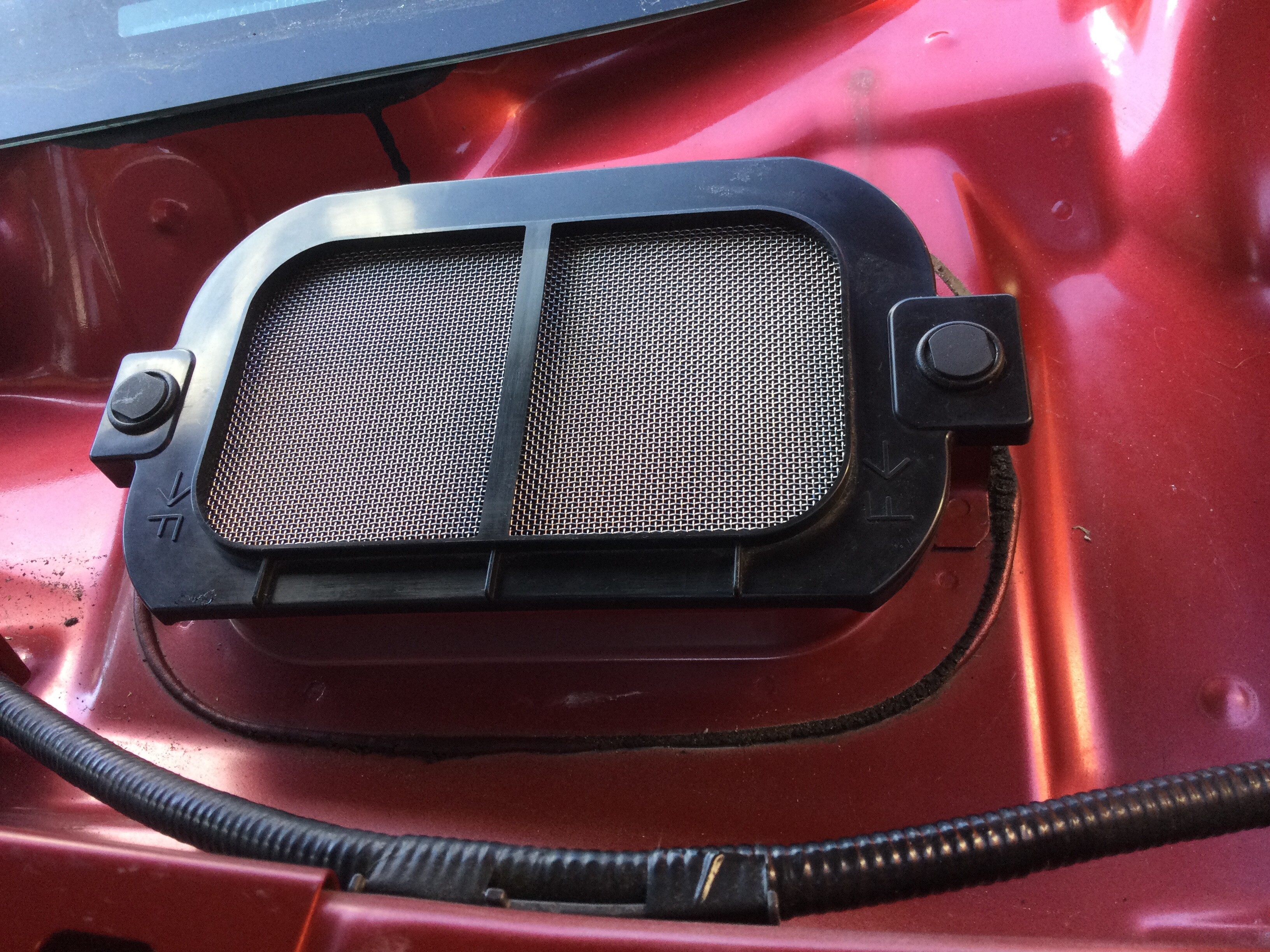

Checking the cabin air inlet vent underneath the windscreen scuttle panel and found it blocked with leaves at the bottom, now I have to remove the filter gauze from inside the cabin to give this a clean which is a bit more involved.
Had the car from new and full Mazda service history but looks like this has never been removed for cleaning in 8 years.
The air inlet at the top is open but has a plastic surround that looks as if it is meant to locate a filter - Is there an aftermarket filter that can be fitted in this opening that will prevent debris from falling down and collecting in the internal gauze as this would save a lot of hassle in future

David no pollen filter. The hole is for a/c. I cleaned mine out today & put a mesh in the cover. Will keep all the leaves & other ■■■■ out. Just got to do the internal one now

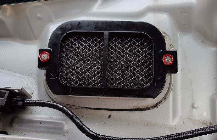

I added a plastic mesh with a 10mm foam filter underneath.
When you say “underneath”, do you mean just underneath the mesh, or in the place accessed from the the cabin.
Does this affect the airflow into the a/c?
David
The foam is right under the mesh. Its reticulated foam used for air filters so doesn’t effect flow at all. Stops almost all crud.
