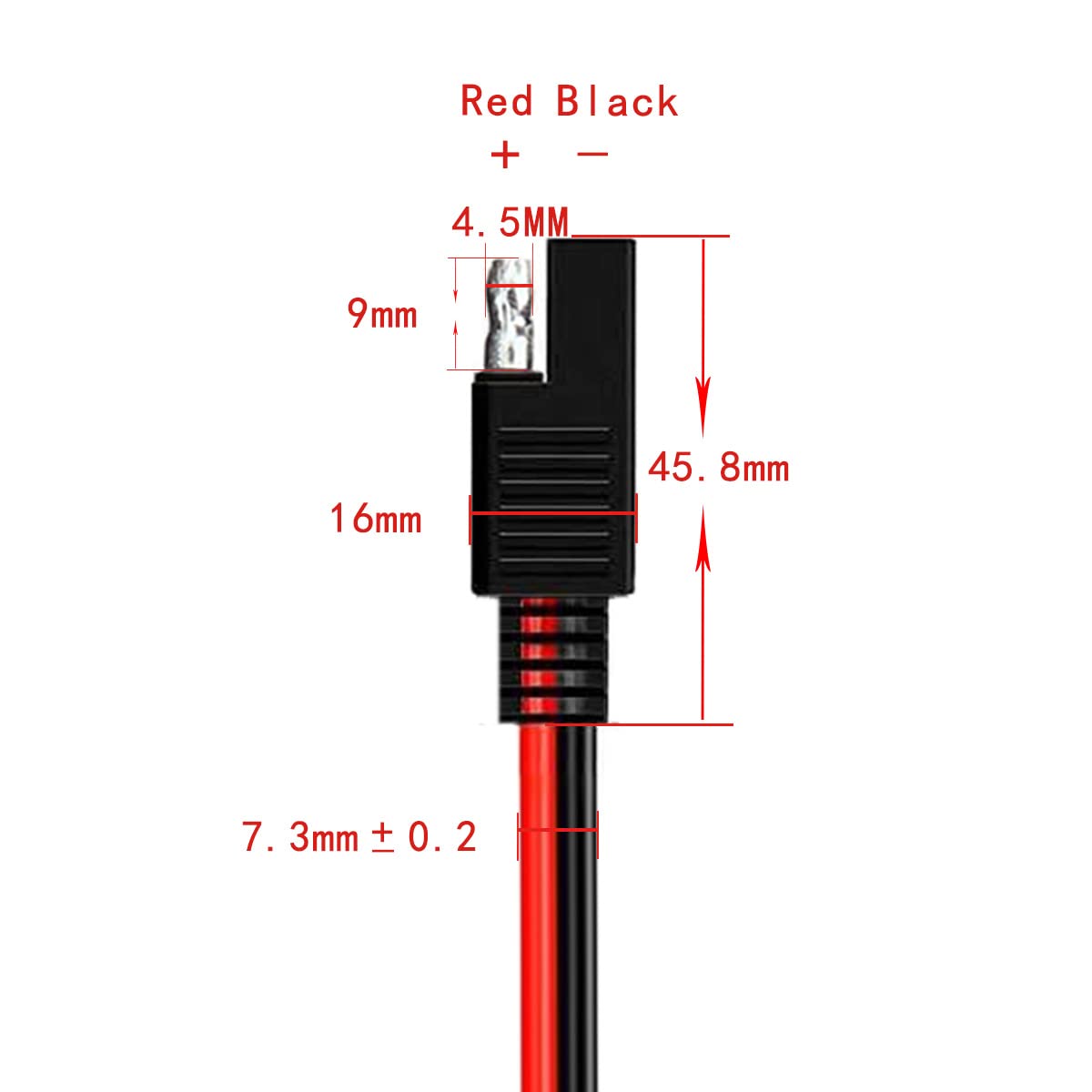

I have no power in my garage but to combat parasitic drain, I have a solar panel trickle charging system using SAE cabling system and plugs to connect and disconnect to battery. However, tired of having to lift the bonnet every time to connect so would like to cable so that connection from solar side is in cockpit. Can’t figure out a route from bay to cockpit, and connector is 8mm wide. Any suggestions please? Or do I cut cable between connectors and feed through small grommet where bonnet release cable enters cockpit perhaps and then reconnect?

Do you mean the grommit where the bonnet release cable passes through the firewall? Npwhere near big enough I’m afraid as plug on end of cable is 15mm.
I’m not sure, it possibly was that. Will the pins not come out of the plug then refit when routed.
If the plug won’t go through the grommet, then maybe consider splitting it, then superglue it back together (grommet)
