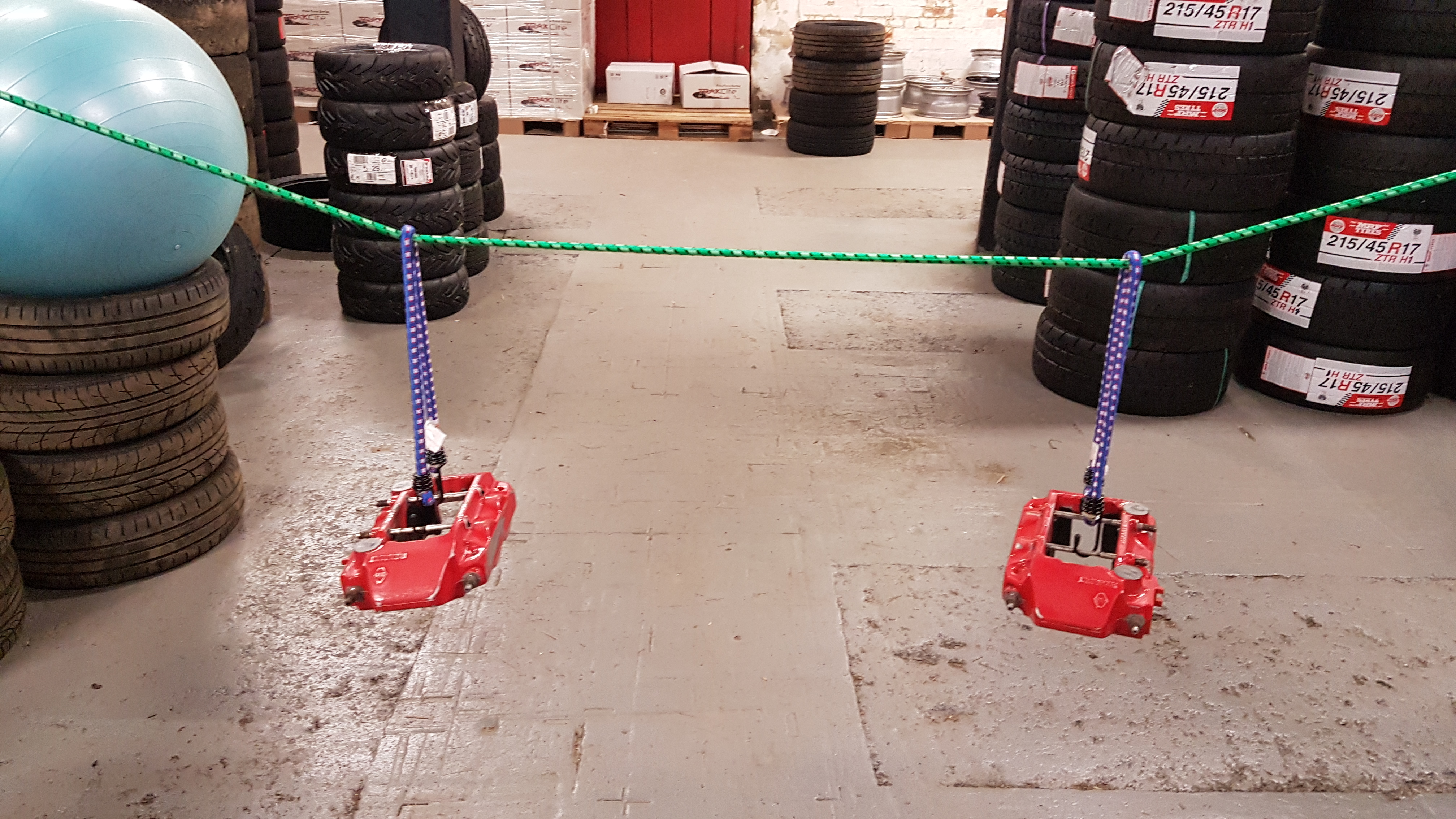

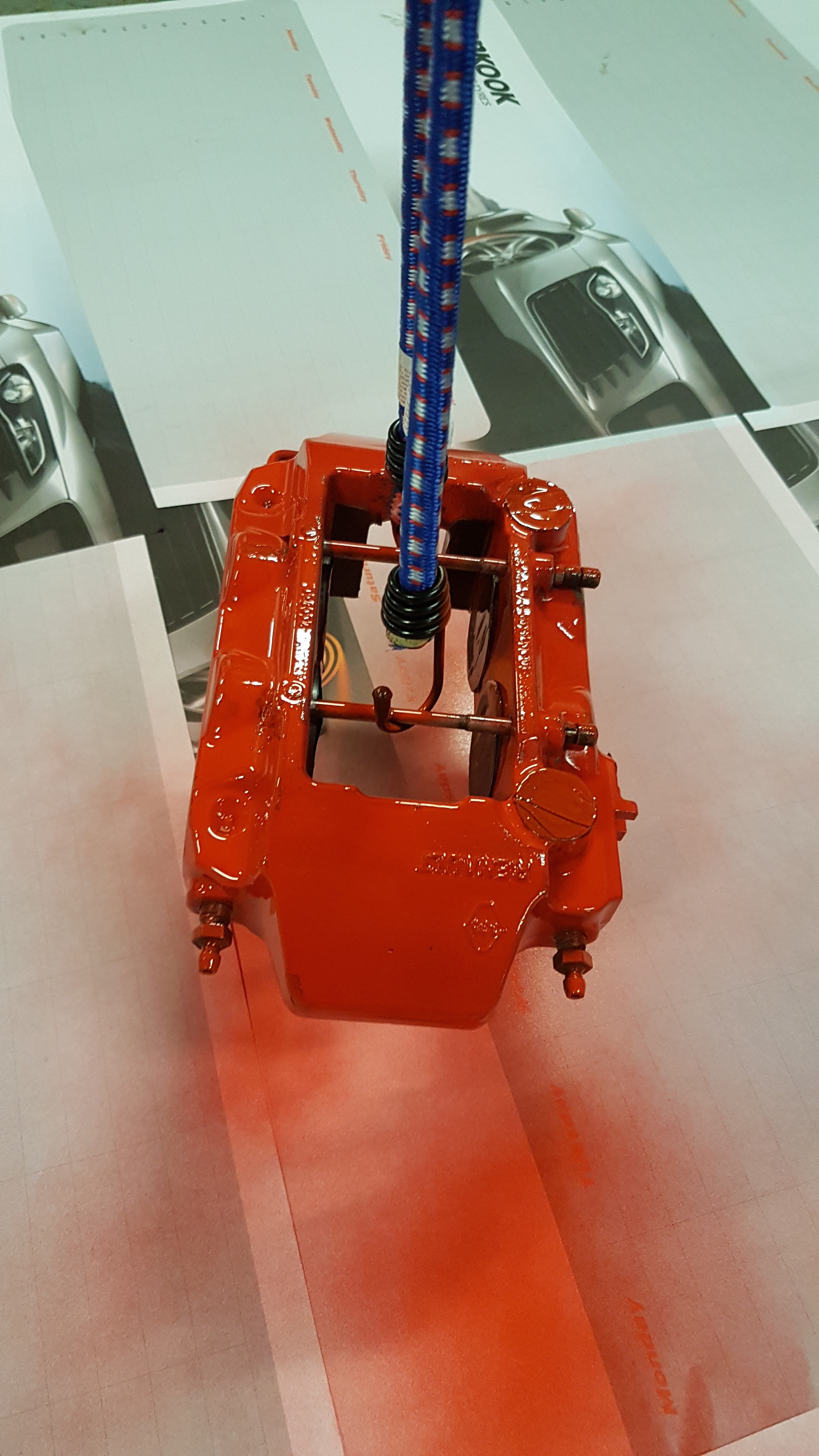

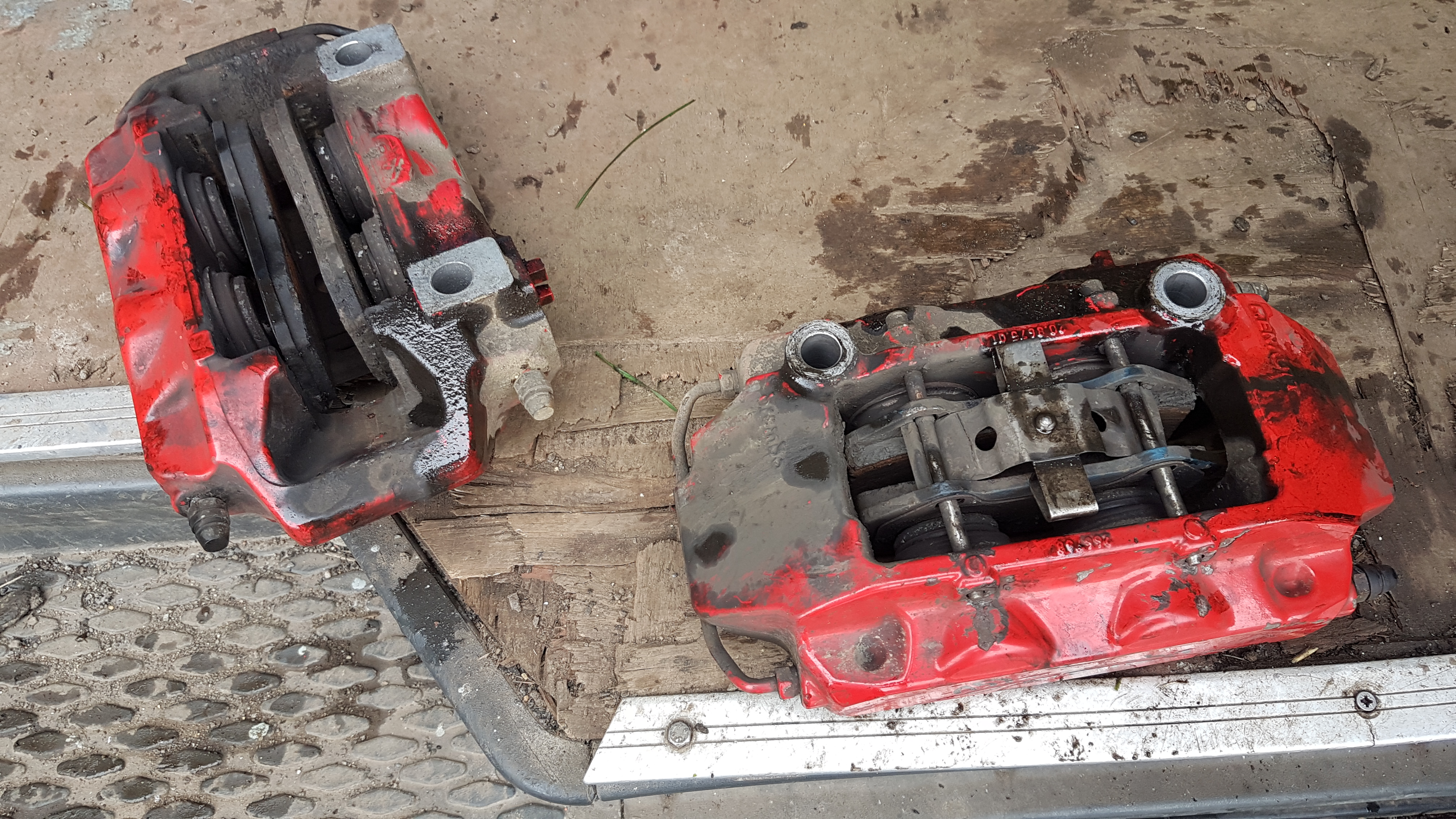

Similar thing, different brakes obviously, but same deal. As said, thin coats applied before the first “sets” or you have to leave it until it is properly cured else the next coat will wrinkle!
