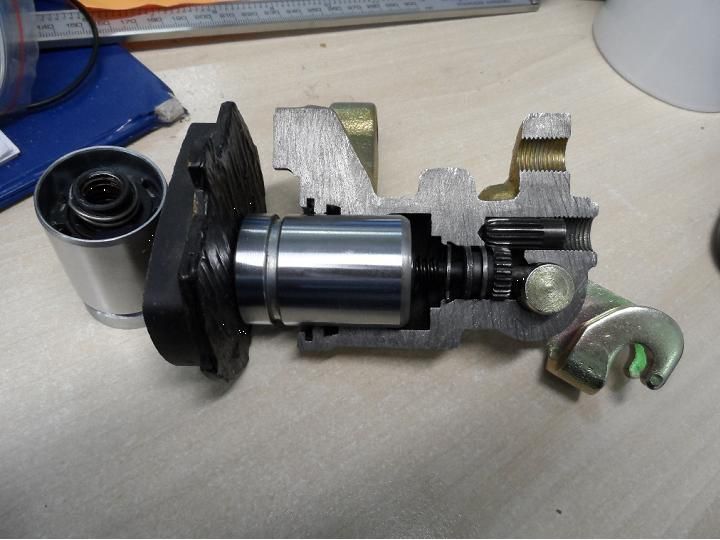

Drivers side is an after market part and has a larger diameter of piston, passengers is standard.
I have found a dissected view of the caliper: http://i110.photobucket.com/albums/n109/saz9961/Slide1-1_zpse61b5462.jpg
