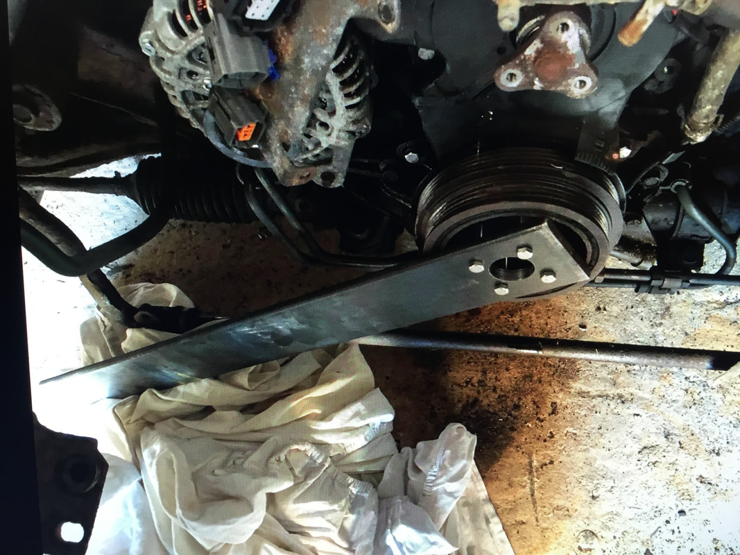

on my mk2 it would not budge , this home made locking tool like this is the answer
