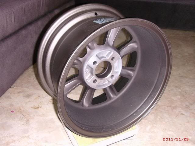

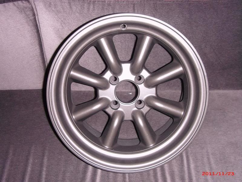

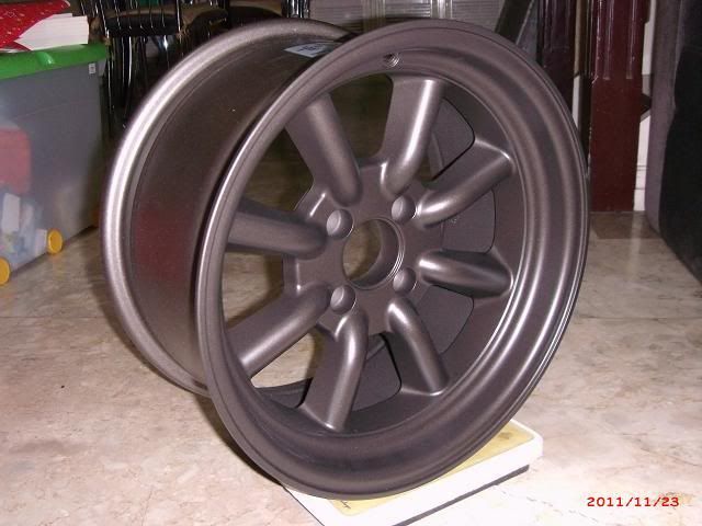

A different sort of retro, but an intrsting wheel, the about-to-be-released Watanabe ripoff, the Rota RK-R, so far only in a stupid 15x8, Zero offset:
If Rota can sort out better fitments, it will render the Rota RB effectively unsellable.
