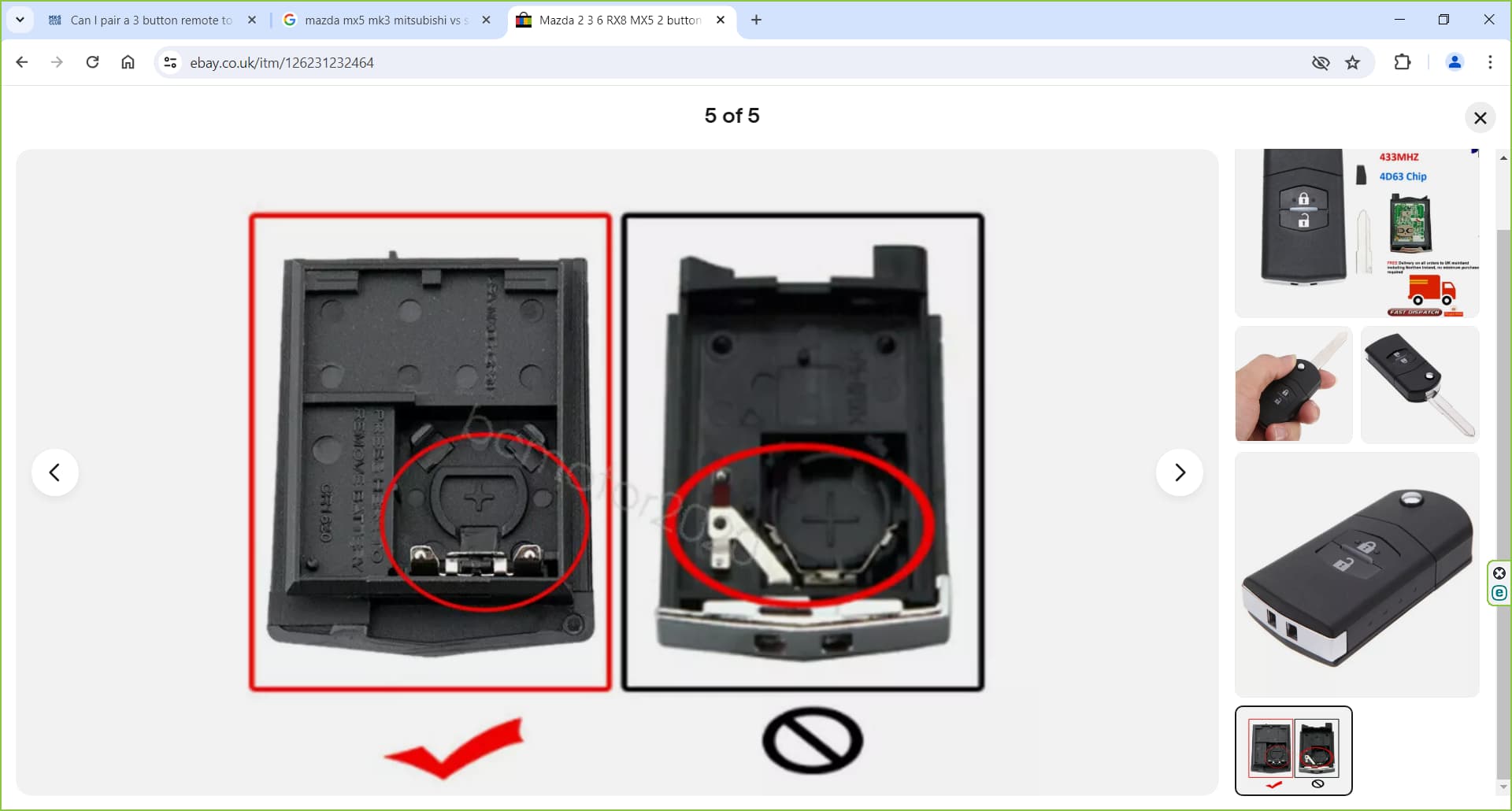

There are two types of key for the mk3 - you need the matching type for the above to work
One is the Mitsubishi key - identified by the mitsubishi symbol on the circuit board.
The other I believe is Siemens.
Have a look at your working key and see if it had any manufacturer ID
Then see if the second key is the same make
EDIT - Siemens key on left ( with tick ) - Mitsubishi key on right ( with no entry sign )

If you do have the wrong fob type - the correct ones are pretty cheap and you can move the blade/chip across to a new fob.
Just some feedback as I’ve now resolved this
You do need to ensure that you have the correct make, the 4 button I got with the car (I only got one key) was a Mitsubishi, the 3-button I bought off ebay was a Siemens and didn’t work. I bought a 4-button one that was Mitsubishi and it worked perfectly, just had to sync the remote with the usual sequence of turning ignition on and off and opening and closing the door (I can’t remember the exact sequence but is easily google-able)
So whether a 3-button Mitsubishi (if such a thing exists) would work I dont know but there are loads for sale on ebay so not difficult to get hold of the right one.
