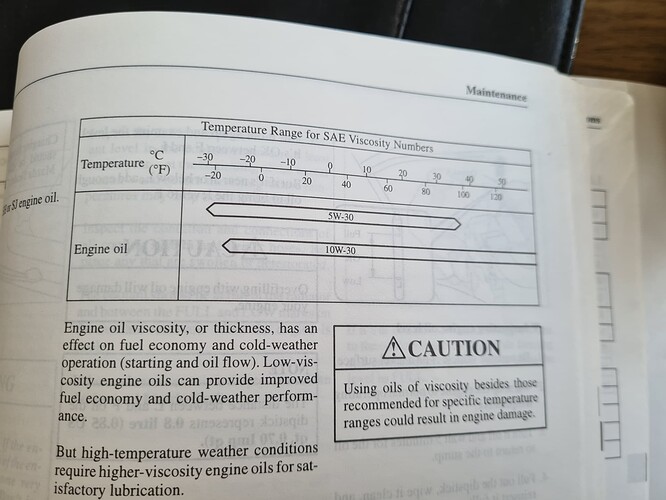

Manual says 5w30 0r 10w30
I suppose that answers my original question?
Or does it?
my comment was more about using semi-synthetic. For the UK mainland 5W30 or 10W40 but the 5W30 would be better if you had to choose from those two.
However I use Mobil 1 Fully Synthetic 0W40 in mine, change oil and filter every 10k or two trackdays whichever comes first.
I always prefer to rely on the actual manufacturer’s own manual for the type, rather than ask for online opinion. :wink:
