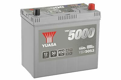

Will 2mm be that critical?
This fits as I put one in my 2013 Sport tech.
Recommended by Yuasa site.
Size Mm: H:223, L:238, W:129.
Better Spec too than the Bosch.
I can second the Yuasa batteries, had that one on my last NC and also have a Yuasa fitted to my daily driver, that was a different spec though as it has stop/start.
Thanks for the info found the Yuasa battery for £58.50 + free next day delivery off the Battery Megastore website.
