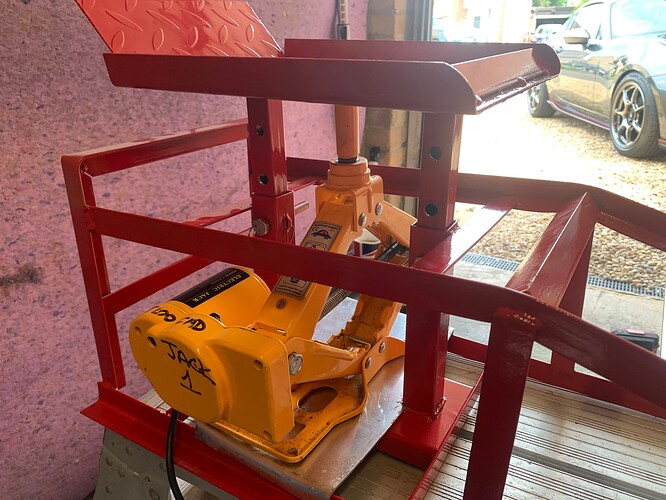

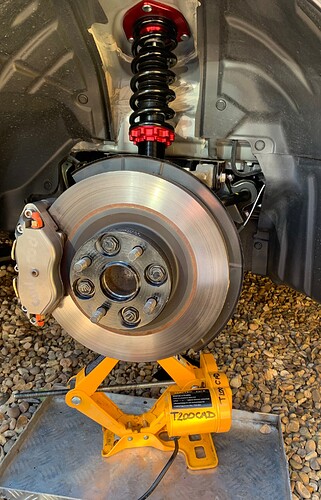

I used these 2.5ton-3ton 12 volt battery bank operated jacks for the past 10 years now real handy for low cars I also use them now on my new ramps to jack them up another 8-10 inchers if need be … :wink:
