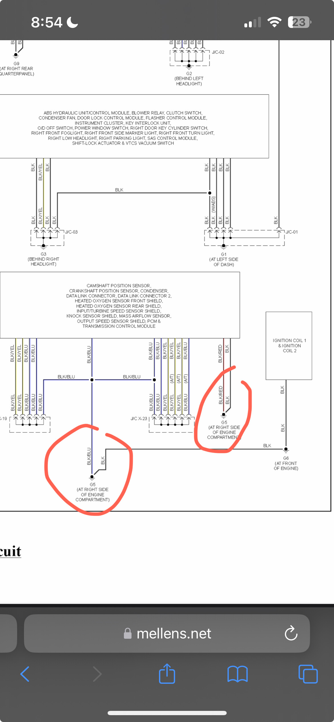

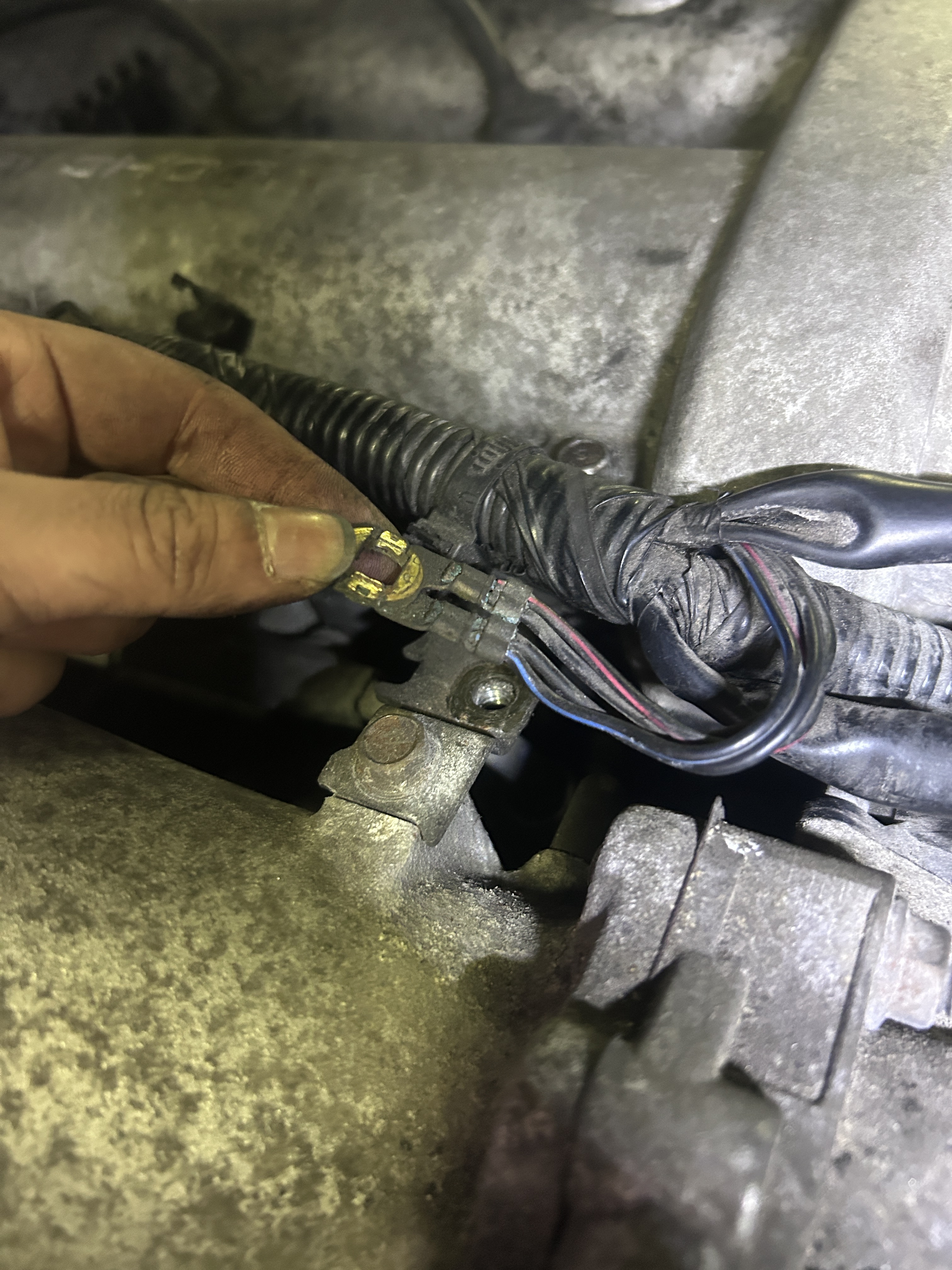

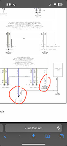

A good news is maybe I have found the problem which is the grounding wire that runs to inlet manifold - the blu/blk & blk and the red/blk & blk crimped in ring terminals. They seem to be super corroded and when I measure their resistance against manifold it shot super high. Will be cleaning it tomorrow. Fingers crossed this is the final answer to my problem :crossed_fingers:
