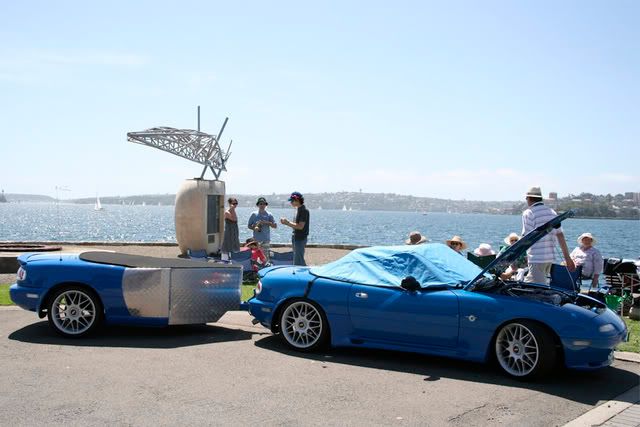

For Taff here’s a bit of inspiration
I agree that the towbar mounted hitch route is the best as long as the vehicle is suitable. I have used the Witter cycle carrier attached to towing brackets on my previous cars for the last 20-odd years, and have only recently sold-on my old trailer which was adapted to carrying up to 4 bikes. A 6 x 4 trailer built on a Metro hydrolastic rear-end rides very well with the relatively light weight of a few bikes.

I wonder if the trailer in Geoff’s photo is made from the back half of an MX5 which split in two while towing a caravan …
