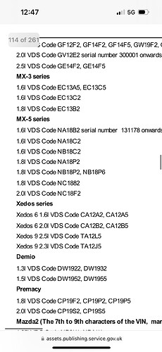

When I then look up my VIN in the In Service Exhaust Emission standards it’s not there.
Even if I look up Mazda MX5 instead of Eunos.
I’m an NA8C…. VIN. If I recall the ‘NA1…’ numbers were for European models only.
Source: https://assets.publishing.service.gov.uk/government/uploads/system/uploads/attachment_data/file/676700/in-service-exhaust-emission-standards-for-road-vehicles-19th-edition.pdf

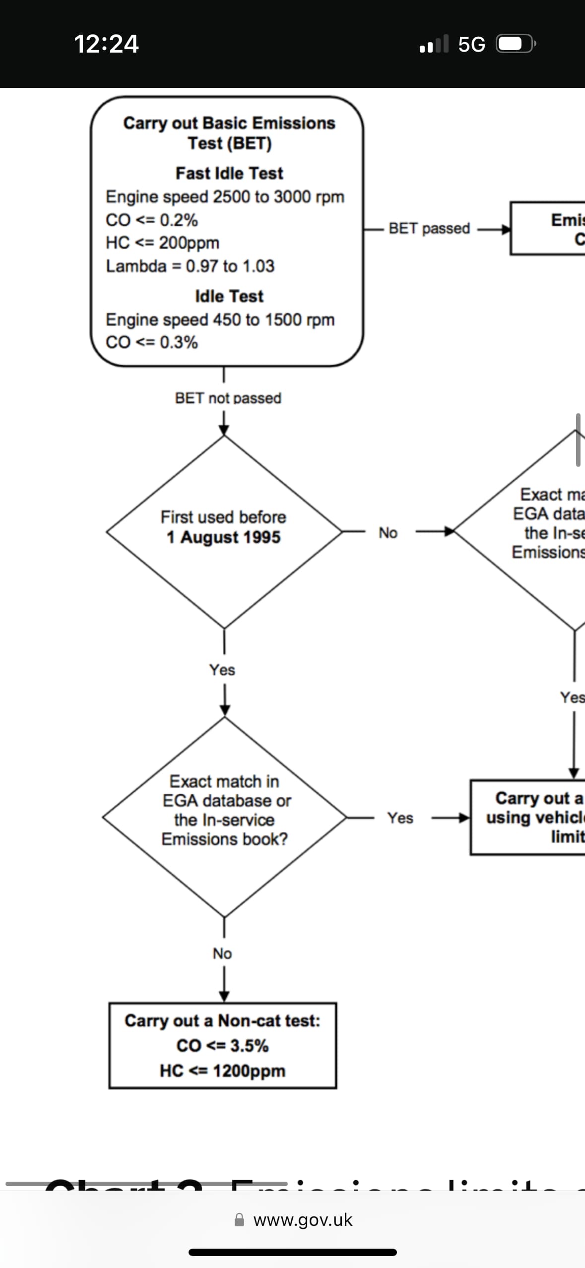

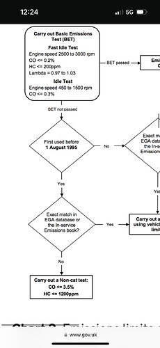

From what I’ve read - like the flow diagram, first used before 01 August 1995 is the cut off.

A 1994 car needs to have a cat test unless of course like a eunos there is no data listed in the data base which there isnt so you carry out a non cat test @ co<3.5% and HC < 1200ppm
Ask the tester that you go to , to follow Chart 2. Emissions limits of passenger cars first used on or after 1 August 1992 which you already have

It really doesn’t matter what your car’s V5C says about the model name as the MOT won’t be based on what the V5C says. It’ll be based on the model as defined by the “VDS Code” as shown in the picture in the second post.
The emissions book that pic comes from explains the VDS Code is the 4th to 9th character of the car’s VIN. For an MX-5 VIN that will produce one of the listed codes. For a Eunos Roadster (with its different format of VIN) it will produce gibberish instead. So the car is not a listed model.
The emissions book also explains that all cars whose codes are listed and were registered first used on or after 1st August 1992 (start of K-reg) should get a full cat test. But it also says that cars whose codes are not listed (which of course includes Eunos Roadsters) and were registered first used before 1st August 1995 (end of M-reg) should receive a non-cat test.
Now the problem is persuading the MOT tester you’re not pulling his leg.
If the car has previously been incorrectly MOT’d as an MX-5 then his computer will probably load up that wrong data again. You can print out and highlight the couple of bits in the Emissions book about the cars from this 3-year transition period which are exempt, but the only time I’ve needed to be assertive about it he was doubtful till I suggested he phone his VOSA rep (or whatever they’re called now - DVSA?). He did, and the VOSA representative was happy to reassure him it’s true.
