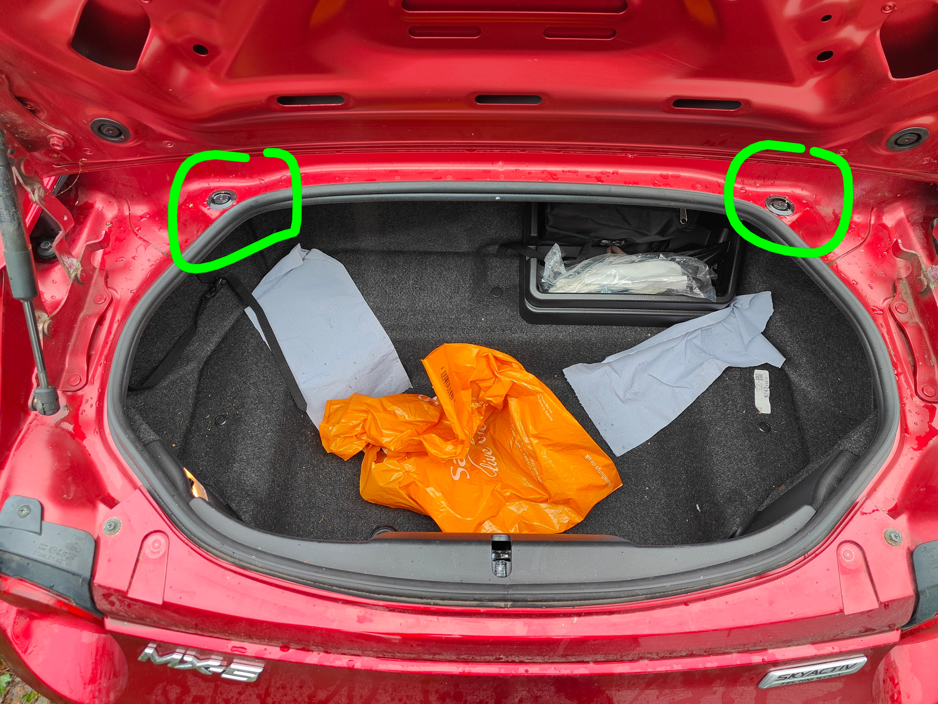

Hi,
The last couple of winters I’ve found water in the boot. Did all the stuff for cleaning the rear window drains. The cause turned out to be the rubber grommets near the boot hinges. When in place they are definitely not tight. I have fixed for now with silicone grease. Is there a better long term solution? I couldn’t find replacements online.
I also wanted to post online because I didn’t see this cause mentioned when I initially searched online.

I’ve also seen that the grommets tend to pool water in the top ribs but I don’t think that was my problem. I think the water was going under the rubber skirt and bypassing the grommet. I don’t think the grommet has a hole, it just doesn’t have a snug fit.
To your point they are just a potential failure point, with more than one way they can fail.
The grommet you mentioned does fill a hole. If you bend down and look under the grommet, the bottom of the grommet can be seen. It’d be just a hole.
Agreed. Let me re-word, I’m not concerned about a tear in the grommet, so I’m not worried about water collecting in the top of the grommet. Just concerned with water going around the grommet, through the hole into the boot.
