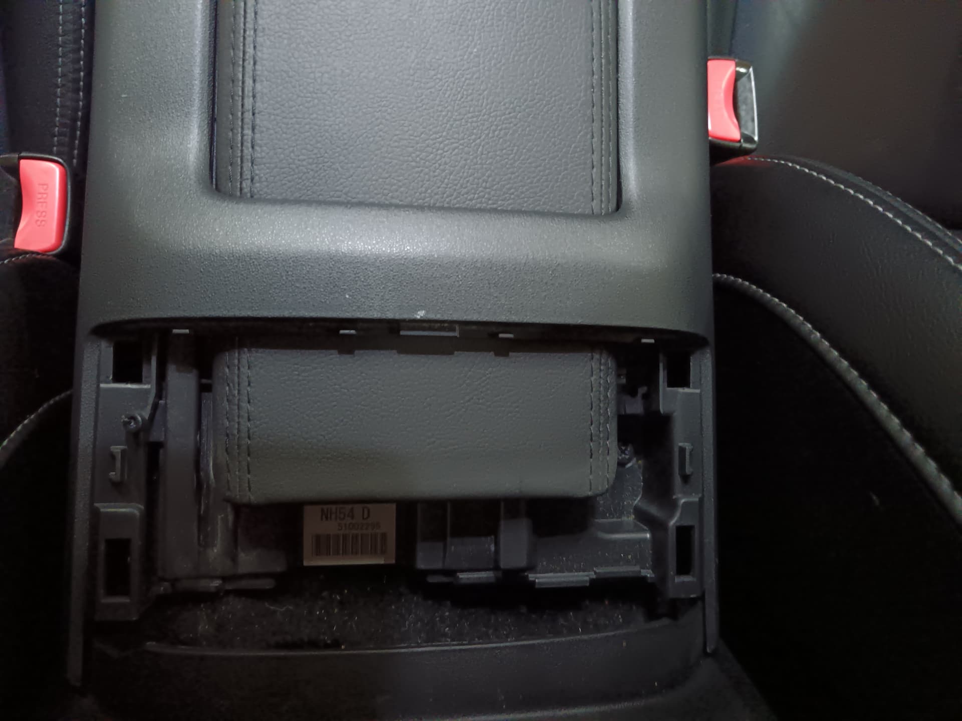

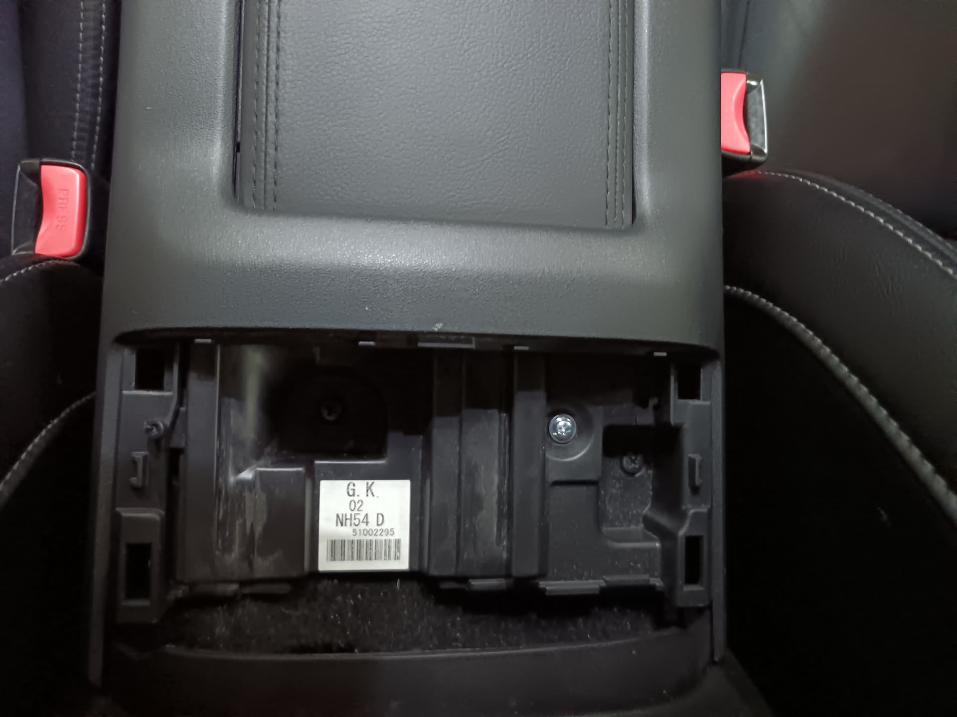

Pop off the little trim panel behind it as I think you can get a bit of access through there. You can see from the second pic that the cover slides back into this area.

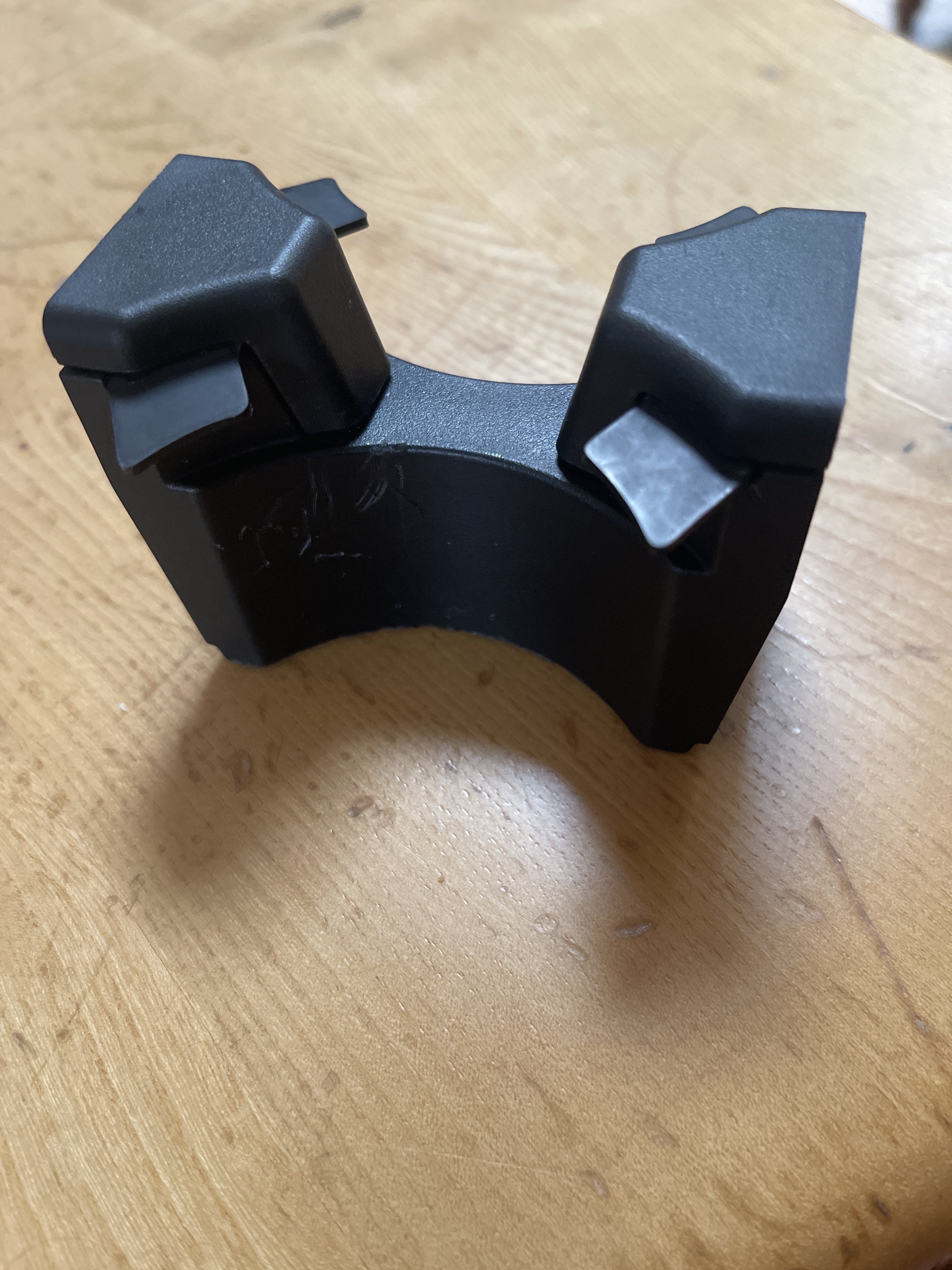

Ps I have now removed the central cup divider bit so fingers crossed this never happens again. I’m so happy I’m away to pour a large vino to celebrate :partying_face:
