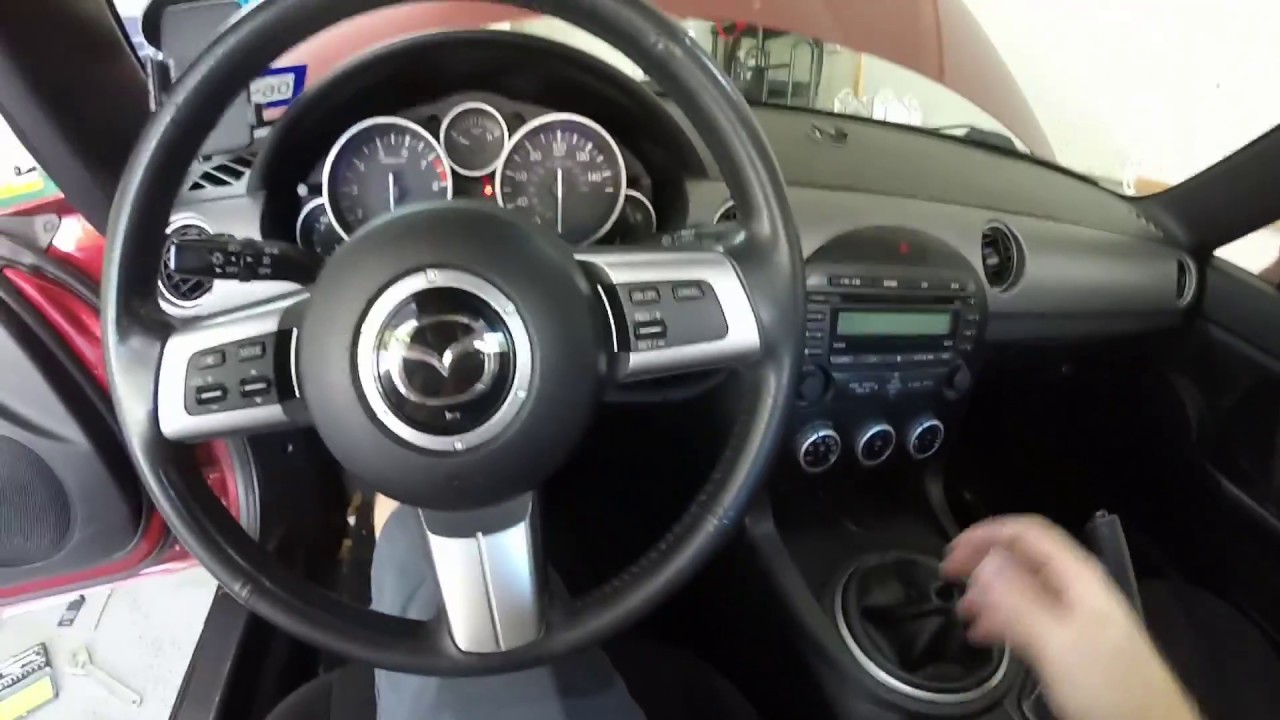

Theres an american chap on youtube called Colored in Light who does a video of both which may be worth a look.
I had a look and it was quite helpful for the slave, but on the master one he doesn’t show any of the process. Just the new one installed.
