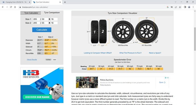

It’s my understanding that the larger sidewall profile will increase the rolling radius of your tyre. This may mean the speedo reading would be out.
Not sure about other safety or legal ramifications.

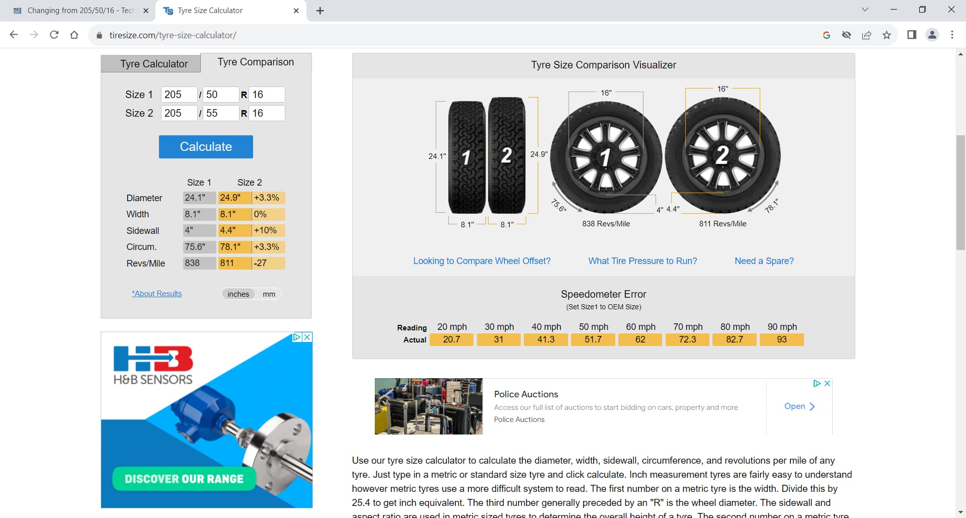

I found this to be helpful for comparing sizes
so would it be ok to change?
Considering there is very little change in speed vs speedo reading - you would have no issues speed wise.
Officially it is a modification so you should inform your insurance company.
the new tyre is no wider/narrower than standard so it will go on the wheel safely.
The unknown is if the larger diameter tyre would catch anything.
Don’t forget that if you do change you will have to tell your insurers.
I run the Vectors in winter on my 16s, but went down to a 195/55/16 instead.
Minimal change in rolling radius and speedo accuracy. As you’ve found, 205/50/16 is a tricky size for all seasons and winter tyres.
