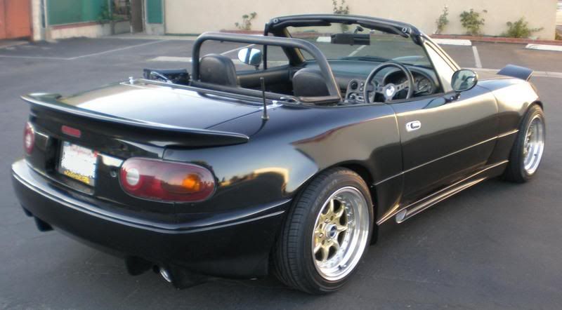

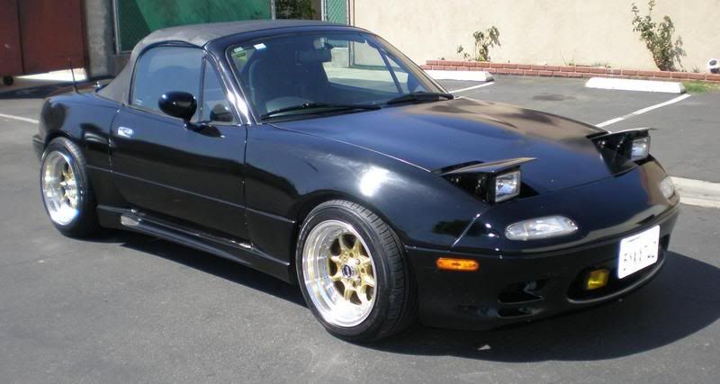

Here’s an actual rhd Miata in California
The owner was somewhat evasive how it was done; contact “RHD miata” on clubroadster.net, though he hasn’t posted there for a few years, so might be dead/ in jail or something.

The black Cali rhd Miata was for sale a little while back:
http://www.hondamarketplace.com/showthread.php?t=2524878
