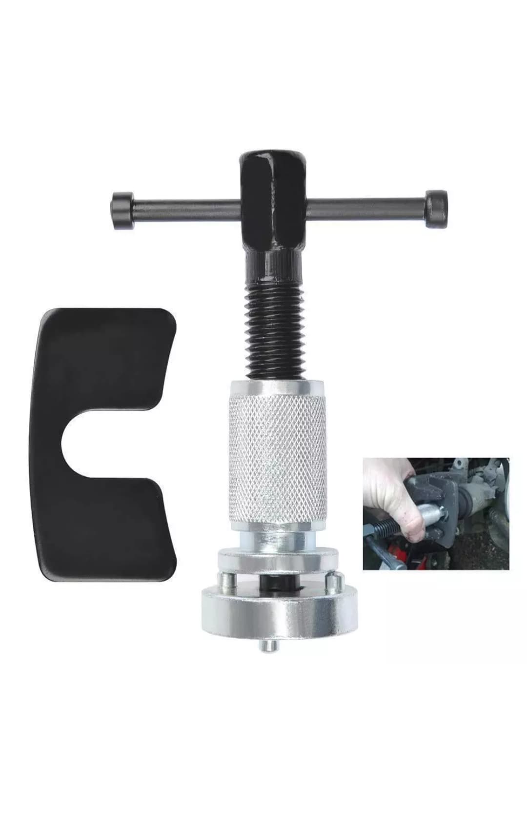

You just push the piston back on the fronts, a G clamp will do it or for both applications I’ve used a tool similar to below but use an old pad as a plate to push on and take that fitting off the end of threaded part.

Well i got it done eventually. The c clamp I’d bought to push the piston back was as much use as a chocolate teapot. Fortunately my neighbour had a brake wind back kit like the picture Mick AP posted above and i got it done. So front brakes changed and working ok. Like most jobs it was a lot easier with the right tools.
Wind back kits are about a tenner + and cover a lot of cars. Just tuck it away after you have changed the pads. It will, likely, work on your next car too.
