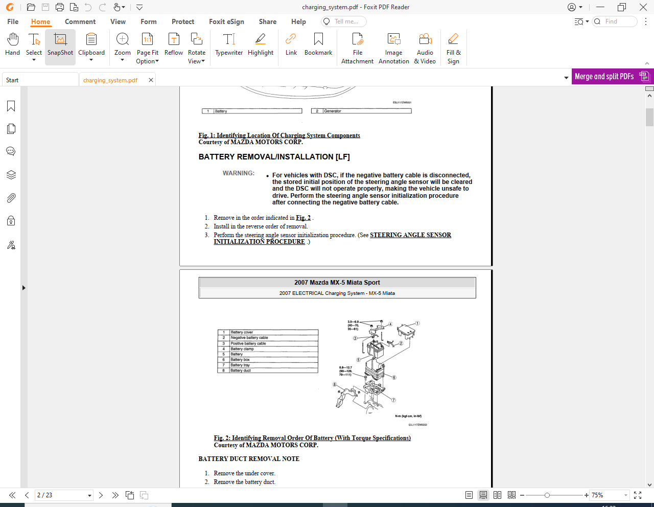

  1. to remove the battery and its tray?

  1. Ideally yes but not essential if you have skinny hands and some patience
  2. Nope. Unless you are doing it without removing the battery and surround as it would make things easier.
Removing the battery and surround is a very quick job and does make the whole thing simpler, the surround does come off by itself so you don’t have to unbolt the tray that supports that battery. I can’t remember how it is attached to the tray right now though

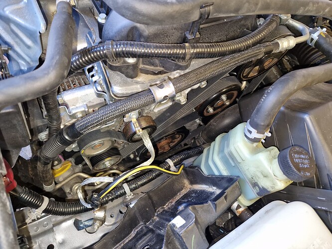

Easy - See Below
Just don’t drop the battery clamp retainers into the undertray when you have removed the retaing nuts as you will have a dreadful job to get them back!

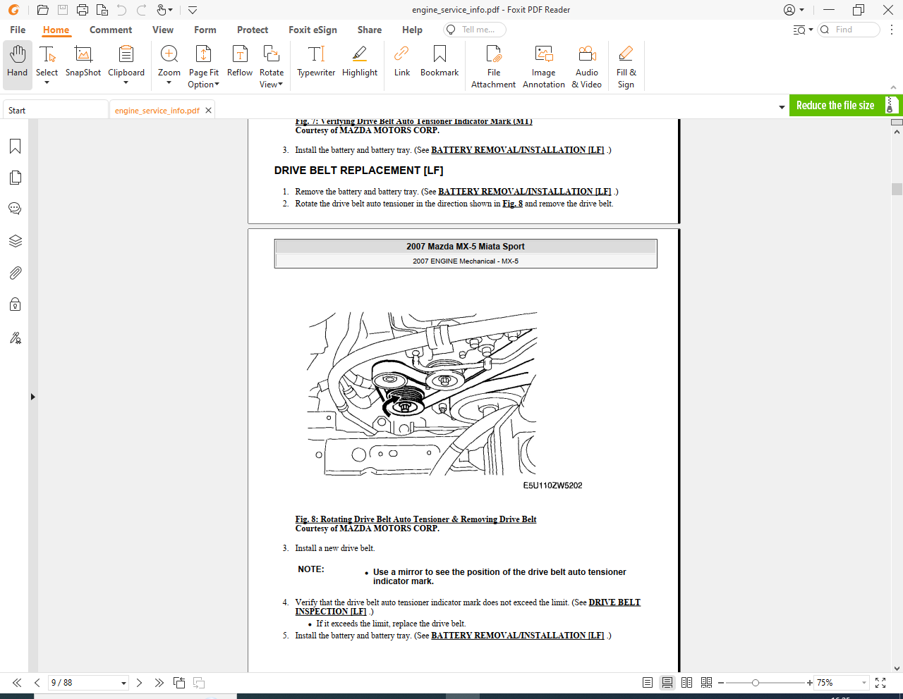

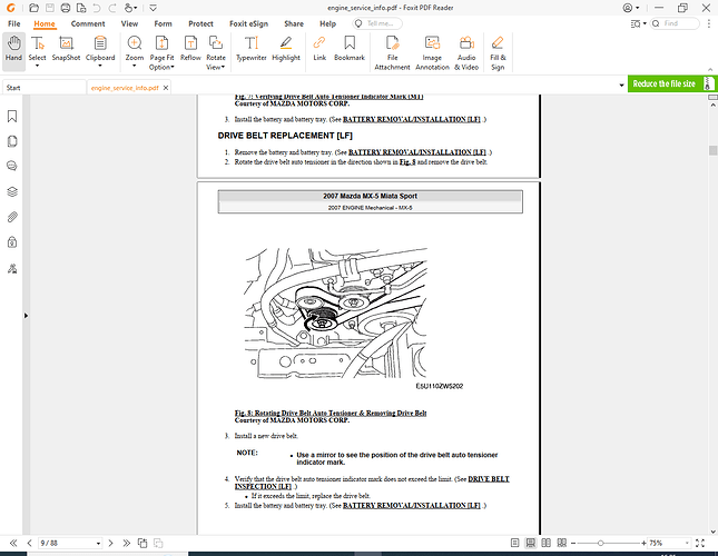

Get the correct belt, air con, non air con types. See diagram below how it goes, release the belt with the tensioner pulley. The aircon models will have the larger pulley bottom right :+1:
Also be prepared to check the tensioner and idler pulley(s) for grumble/click.
They should be silky-smooth and silent.
