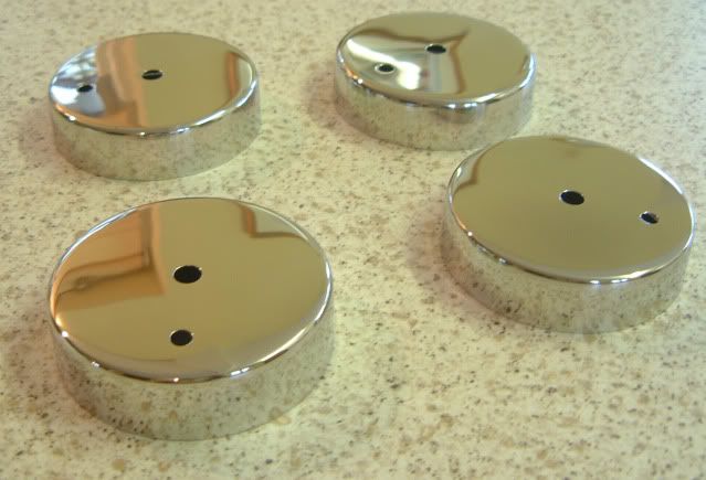

Why not fit one of these instead of removing it?
Because they make the car heavier and don’t free up any space. If your goal is to improve performance or make room for something else (like a remote oil filter) sticking a shiny thing to it doesn’t help.
