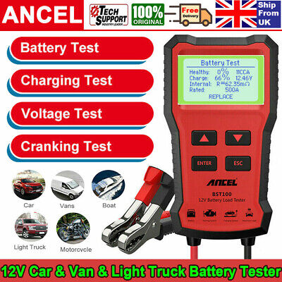

OP…get yourself one of these below but i reckon it’ll tell you your battery is knackered anyway.

Thanks Mick
I already have one of these, in Topdon guise.
