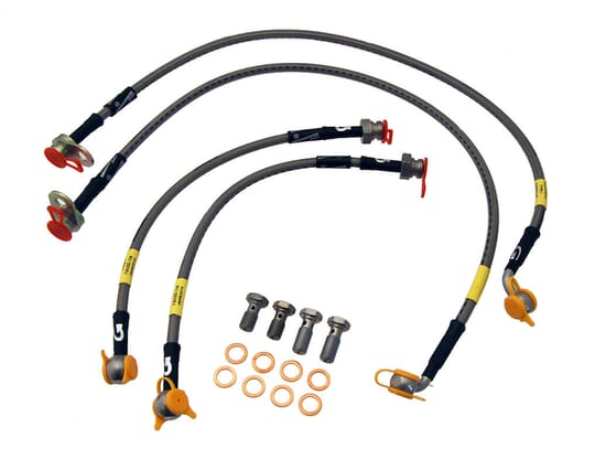

Just to add to the brake line thoughts. The Goodridge ones were rubbish, without the correct mounting brackets. Get the IL Motorsport ones which fit great and do improve pedal feel. Pictures on MX5 parts clearly show the differences. Yes they are more expensive but do you really want to cable tie your lines when a proper mounting has already been provided?.
