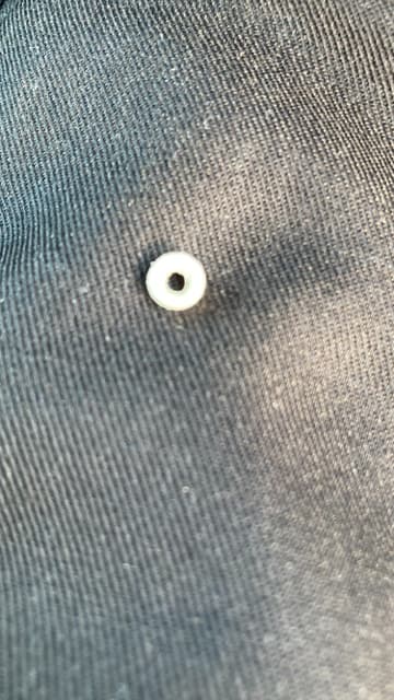

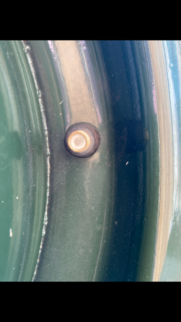

Just to add to this I recently had problems inflating the tyres on one of my vehicles and could not work out why. At first I thought it was my inflator but I found out it was down to my caps. The caps had a white rubber seal inside them which had come out of all the caps and stuck inside the valves stopping the air going into the tyre. Seals removed and all was well.
