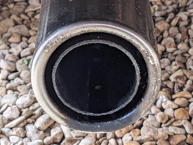

What’s the best way to clean up the exhaust tips?
WD40 and a kitchen scourer (plastic, not metal) works eventually but is there something else which will do a better job of loosening the deposits?
I’m thinking something like STP fuel system cleaner (with the rest going in the tank) but haven’t tried it yet.
I use this, works really well
Probably best not to use scourers as they may damage the chrome finish
I use autoglyn engine cleaner. Gets them nice and shiny
Fine grade wire wool and elbow grease has always done the trick for me.
Hmm, that also looks like it’s running a little bit rich, too much for the cat to clean up, if so it will soon be dirty again.

Don’t think they are chromed, just polished stainless steel so they’ll take a little scouring with wire wool.
Unburnt petrol making soot in the exhaust. Its a sign of something could be improved. Air cleaner clogged? Air leak? Timing? Bad fuel? Bad plugs? Dead cat? Burning oil? etc, etc,
Our cars have lean-burn engines, and the exhaust should be bare metal maybe with a hint of pale brown.

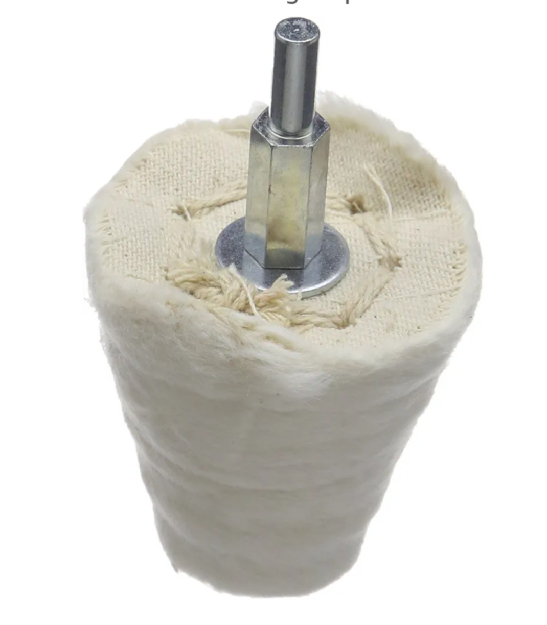

Cone polishing goblet that attaches to a drill plus any sort of polish you have at hand
Autosol etc will take less time as it’s quite abrasive but any polish will give you a decent finish
Can be a bit messy as it flings contaminated polish around so use a slow setting (not the hammer setting!)
If that exhaust pipe in your pic is wet and sticky, that is most likely from oil, and it looks like it has been doing it very slowly for quite a while to become more like tar.
However, yours is nowhere near as thick, sooty and tarry as a “low mileage” NC I walked away from at Car Giant nine years ago. I showed the obnoxiously pushy salesman the Vextra’s immaculate exhaust as an example of what it should look like.
There are many routes for oil to get through the combustion system, rings, valves, EGR, PCV breathers, etc. It doesn’t need to be much at all on some routes; for example if its being drawn in on the overrun when the engine is on maximum vacuum and no petrol being used to burn it off again.
There are lots of possibilities for a slight richness (and not necessarily oil burn), enough to still pass MOT, but adversely affecting mpg and clogging pipes, eg dirty MAF and air leaks.
If the MAF has become slightly contaminated with a faint hint of oil from your K&N, and then being sticky trapped some fine particles that squeezed through the K&N, ECU will think there is more air mass going through than reality (especially on low throttle) and richen up to balance out the mixture. Easy fix; clean the MAF with appropriate care.
Tiny air leaks in the exhaust can fool the o2 sensor into thinking it’s too lean, and again the mixture will richen up to compensate. This is more difficult, but a stethoscope can be very effective in locating such IF you know how and what to listen for; it’s easier to demonstrate than explain.
This forum has loads of expert advice on these topics, don’t just take my word for it, and it only needs a careful search to find useful solutions from them.
Have fun, after all it is an MX-5. More smiles per mile… :grinning:
