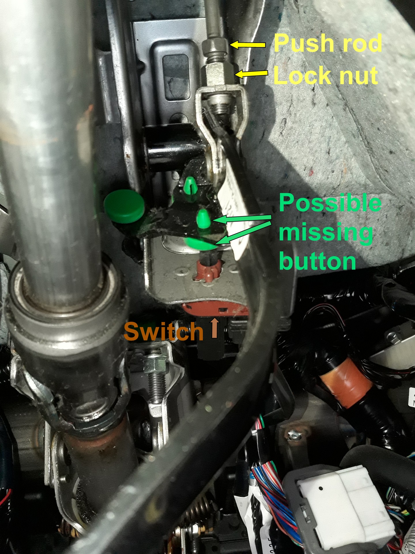

I suggest using a mobile to take some photos of the pedal box, rods and levers etc, to get a good idea of what is in there before attempting any work.
Clutch push rod adjustment and pivots, close-up view equivalent to head on floor, pedal in face, looking up at it.
from this picture
