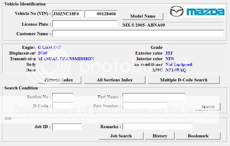

VIN number is JMZNC18F600128406
Thanks again for your help :slight_smile:
That VIN shows the car as not having Air Conditioning so it seems either someone’s retro fitted some(?) parts of an AC system to it or just fitted an Auto AC panel.
