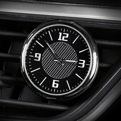

Since updating my head unit, I’ve been disappointed with quality of the clock function. It’s a very small display and almost illegible in certain light.
After searching the net, I found this little beauty on eBay.
Arrived today and I’m really pleased with the result. Compliments the piano black and the heater vents really well. In my opinion…

I agree about the tiny digital clock on the satnav screen so I fitted this. Note the Mazda logo too.
I should have done better with the double sided sticky pad provided so need to find that black felt tip pen.
The ad said it was visible after dark with luminous hands, but it isnt alas.
Never seen that one done before, off a Mk3 Mondeo? Looks good, different!
Usual E36 B M W clock in my Mk1, but i went with the rarer left hand drive version as wanted the clock nearer to me and looks much better too i think!
I think it was out of a Ford Ka, but knowing Ford it would be in all models. In hindsight the position (central) makes it hard to see from drivers side when in 5th gear (big knob in the way🥴) the bmw clock looks the way to go - but more expensive.
Yeah the BMW set up is a little more costly but well worth it, the wiring was £4.99 and is available off eBay, same as the clock and frame - think I paid £10 ish for the clock and £20 ish for the frame!
