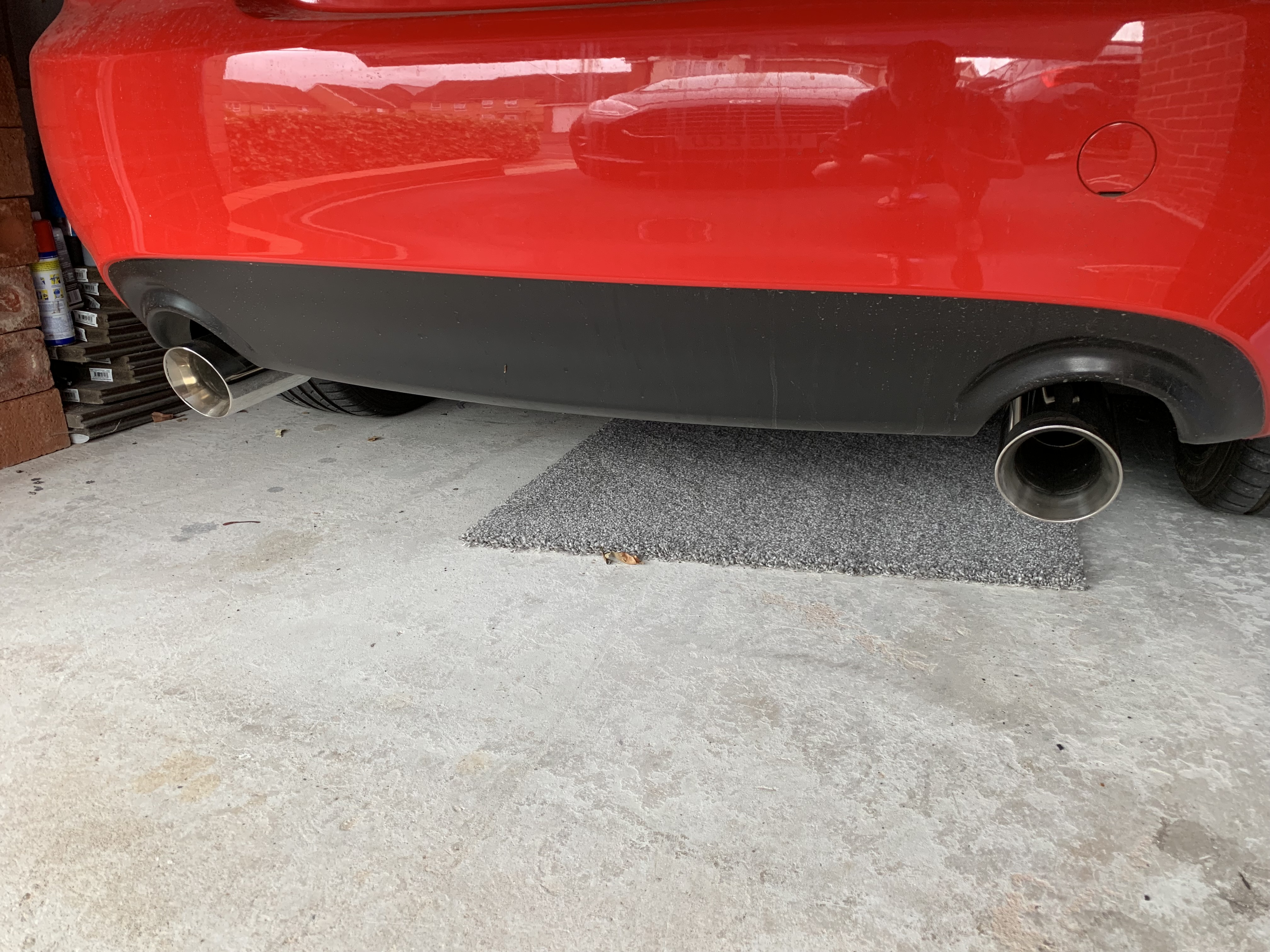

Also, and this is probably just my OCD kicking in, but I’ve noticed that the right exhaust pipe sticks out slightly more than the left pipe…is that normal…
It can obviously only bolt to a fixed point so does it just need the position adjusting on the mounts…. Or is it just how it is…?

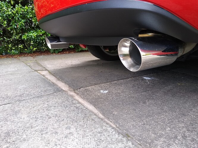

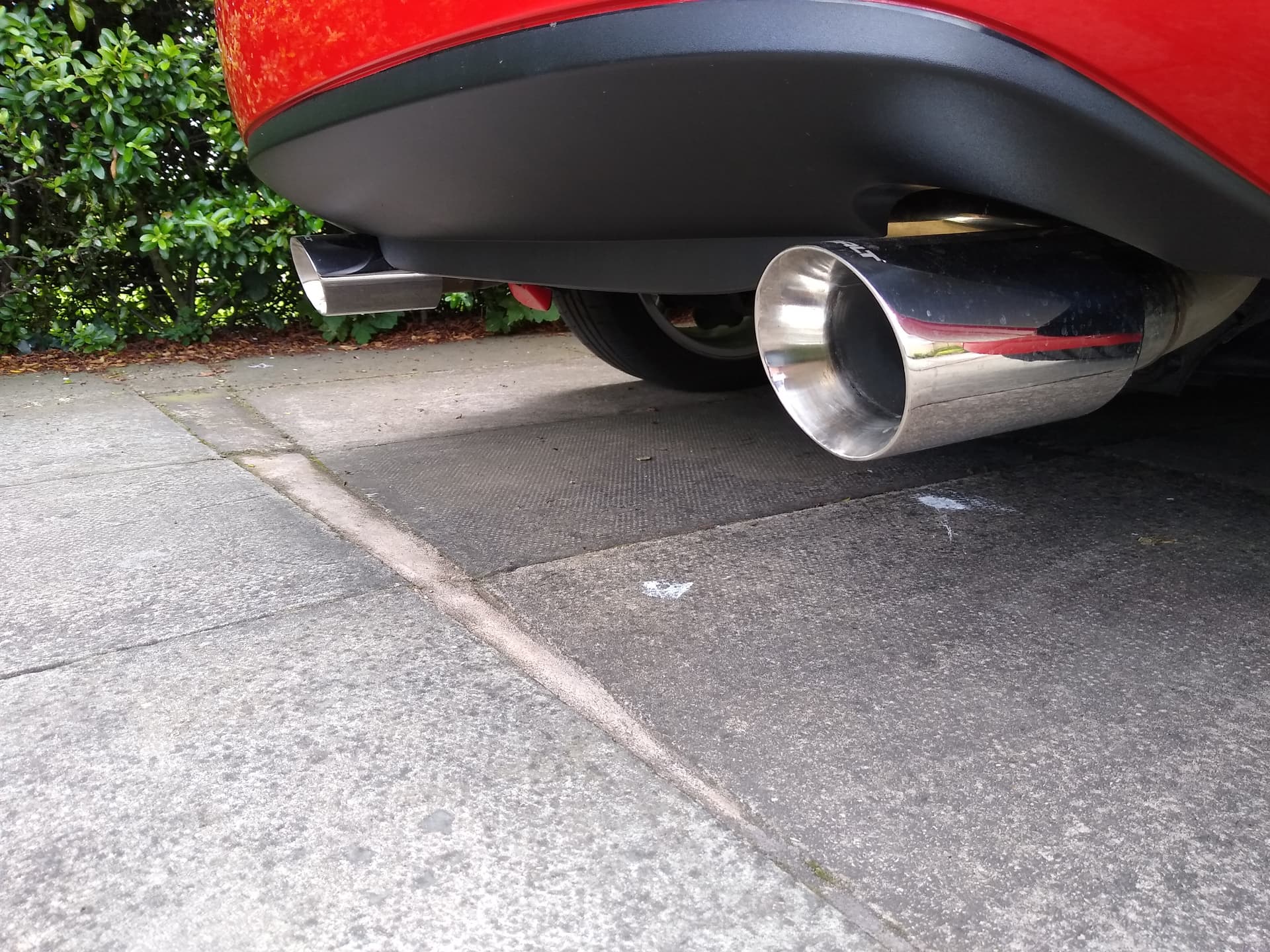

My offside tailpipe sticks out around 10mm more than the nearside and “toes in”. The nearside is square on. This suggests that the tailpipes were not attached with a laser guided device but by a bloke with a welder.

I know I’m being over critical in terms of the exhaust not hanging symmetrical, I just like things to be how I expected especially when paying out of my pocket for them…
As has been said, it’s an exhaust after all, not a precision instrument or something being used by NASA, so the fact it is slightly off, by no more than 10-15mm, I can certainly live with it and won’t be going back to stock, partly because that had to be cut off and isn’t useable anymore…
You can only really tell if you get down to the same level as the tail pipe and compare them against each other so no biggy really, and after all, it’s been bought for the sound more than how it looks…

So, I emailed Moss with a side on picture from both sides showing the 10-15mm difference in the tips. Really just to see what there reply would be more than anything else, and expecting something along the lines of them being manufactured within certain tolerances etc…
But was pleasantly surprised today to get a reply telling me that they would gladly send me a replacement and then arrange to collect the current back box from me at my convenience… wow, excellent customer service…
The tips not being equal doesn’t really bother me as it’s the sound more than anything that I got the exhaust for, so will see what my local garage would charge to swap them over before making a decision…:thinking:
