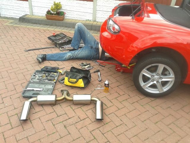

I have been spraying the bolts and hangers hoping to get off without to make trouble although will cut bolts  on if they dont move.  I will try and take pictures as I go and put them on here.

Back the car up on ramps then undo the two 10mm bolts and use a good quality 17mm ring spanner or hex socket then squirt the hanger rubbers with washing up liquid and wriggle the hangers off, job takes 10-15mins your original gasket should be ok to re-use.
Just don’t drop the backbox on your head.
It hurts, yes I know.
Thanks both. Have been spraying bolts so hopefully won’t need cutting off. Good point about not dropping box. cheers

Good luck with the nuts; mine were all rounded, had to grind  off
hi Steve sorry for the delay in responding I’ll add an audio file when I get back home at the weekend  I don’t think the race box is to loud,I do have the rest of the system standard though  Due to time I took the car and exhaust to our local walkers to fit  Only charged £30 to fit
