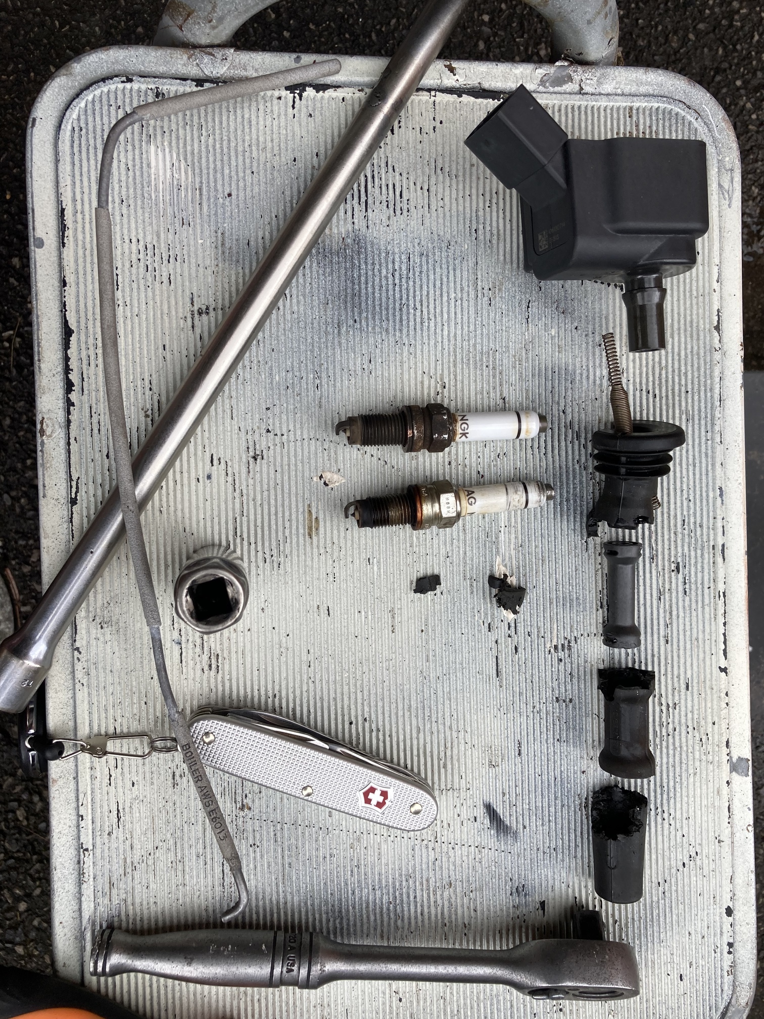

I now have a 5th option.
5, A 5/8"/16mm hole saw which slips nicely over the spark plug ceramic making the job a breeze if the boot end snaps off and is seized/welded to the plug.
Car is being dropped off tomorrow and weather dependant i’ll get it sorted.
All done. With a combination of 5/8” hole saw, long nose pliers, WD40, a bent welding rod and 2 hours grunting and poking about, the final 2 plugs will be done next week when my lad takes a couple of days off work and i can get a free run at it.
