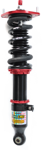

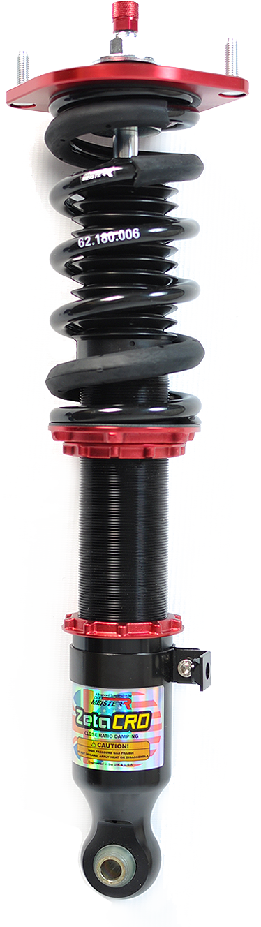

Usually “upgrade” means fit coilovers that are adjustable on ride height and firmness, whereas the OEM is set on both dependant on the springs fitted.
Coilovers as referred typically have adjustable dampers and allow easier fitment of different springs i.e spring rates and lengths, affectively an adjustable damper with a spring fitting so the springs attach over the damper.

If the car you are buying has decent suspension then you could well be happy with how it rides and looks. They do look a whole look better lowered though, you don’t have to go silly low, most “coilovers” as in the ones pictured are adjustable for height and some adjustable for comfort, harder/softer ride.

So just to recap, ALL mx5/Eunos iterations have coil overs as standard, replacement OEM or aftermarket units are available but they are all coil overs (coil spring over a damper). Folk can get confused and say I’m having coil overs fitted, well you would be, regardless of their origins, as that’s what these cars come with from the factory!
