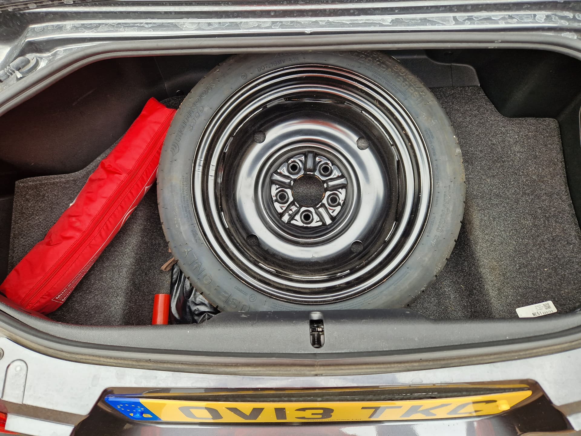

What you need is a Hyundai Coupé space-saver spare with a 125/70R16 tyre. It fits in the boot and just clears the front brake calipers, unless you have bigger calipers than standard.

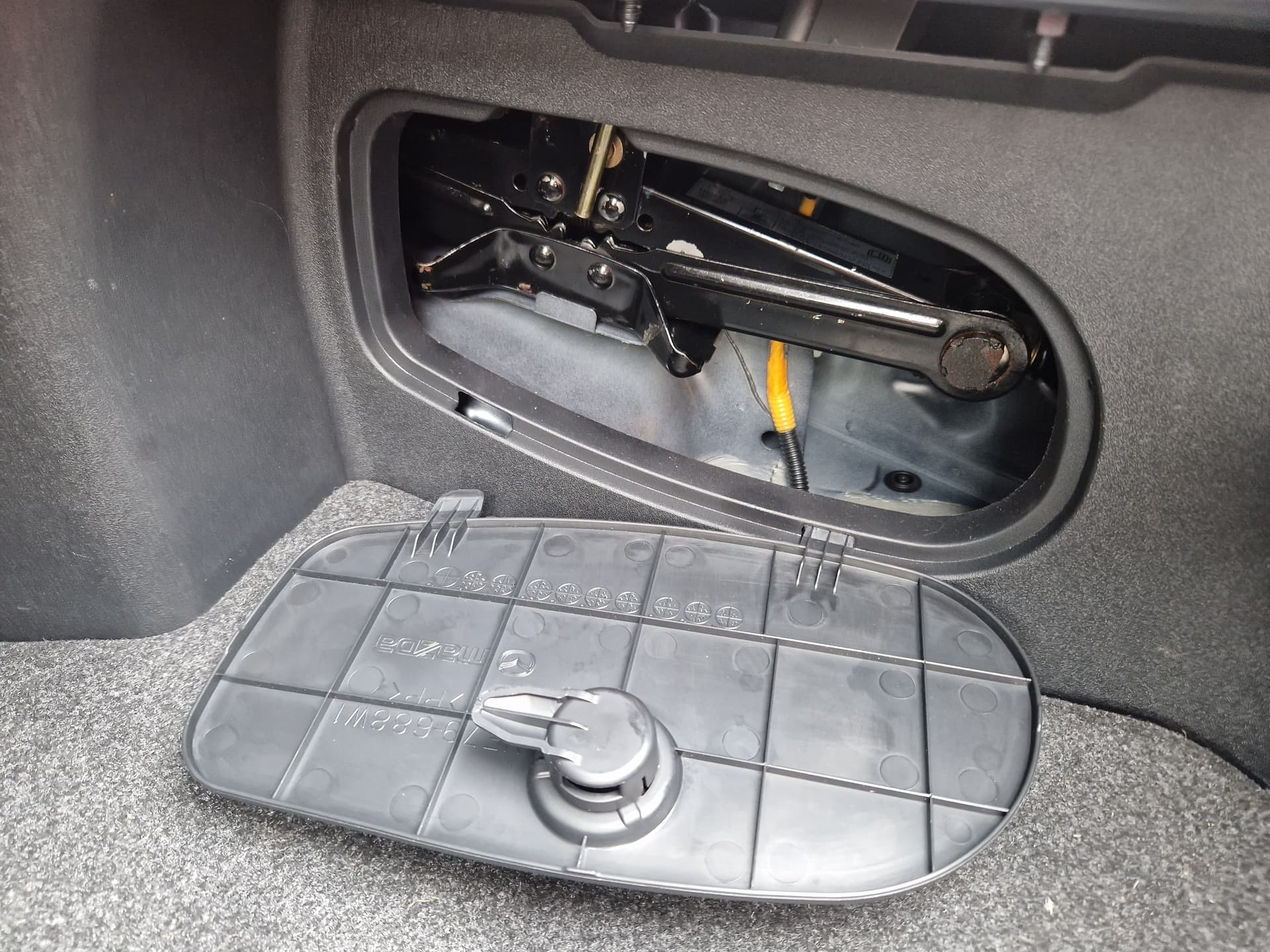

You’ll also need a Mazda jack (mine is from an old Mazda 6 via eBay, but they all seem to be the same) which has its own compartment on the driver’s side, and a wheel brace (or a breaker bar and 21mm socket for an easier life).
Ive already got that setup but its a bit big n bulky. The tyres i am thinking off literally shrink down to the rim when deflated so a full size 16 inch wheel will take up less space that the space saver setup we already have
