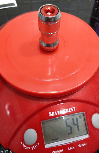

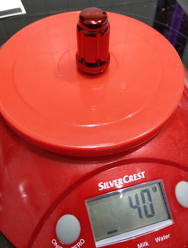

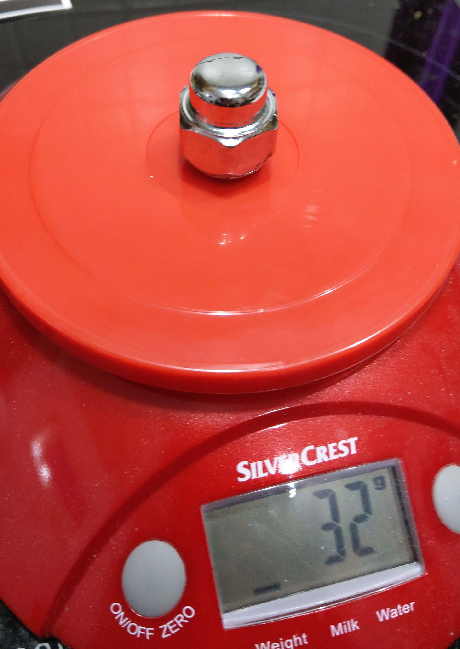

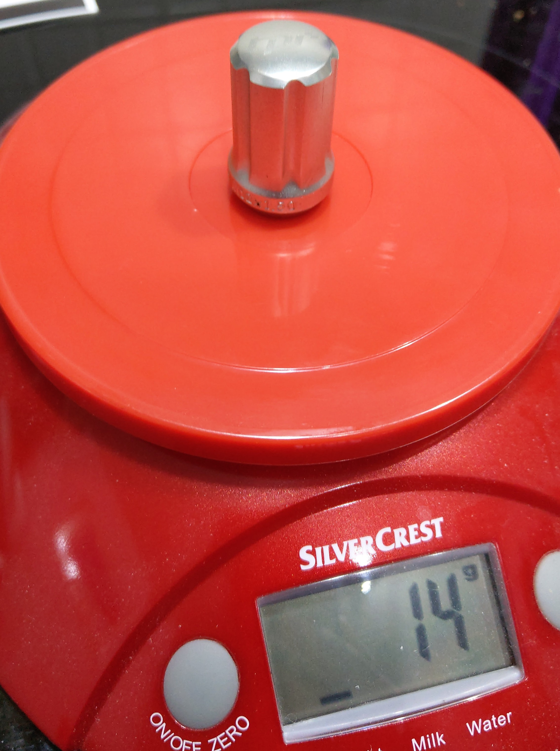

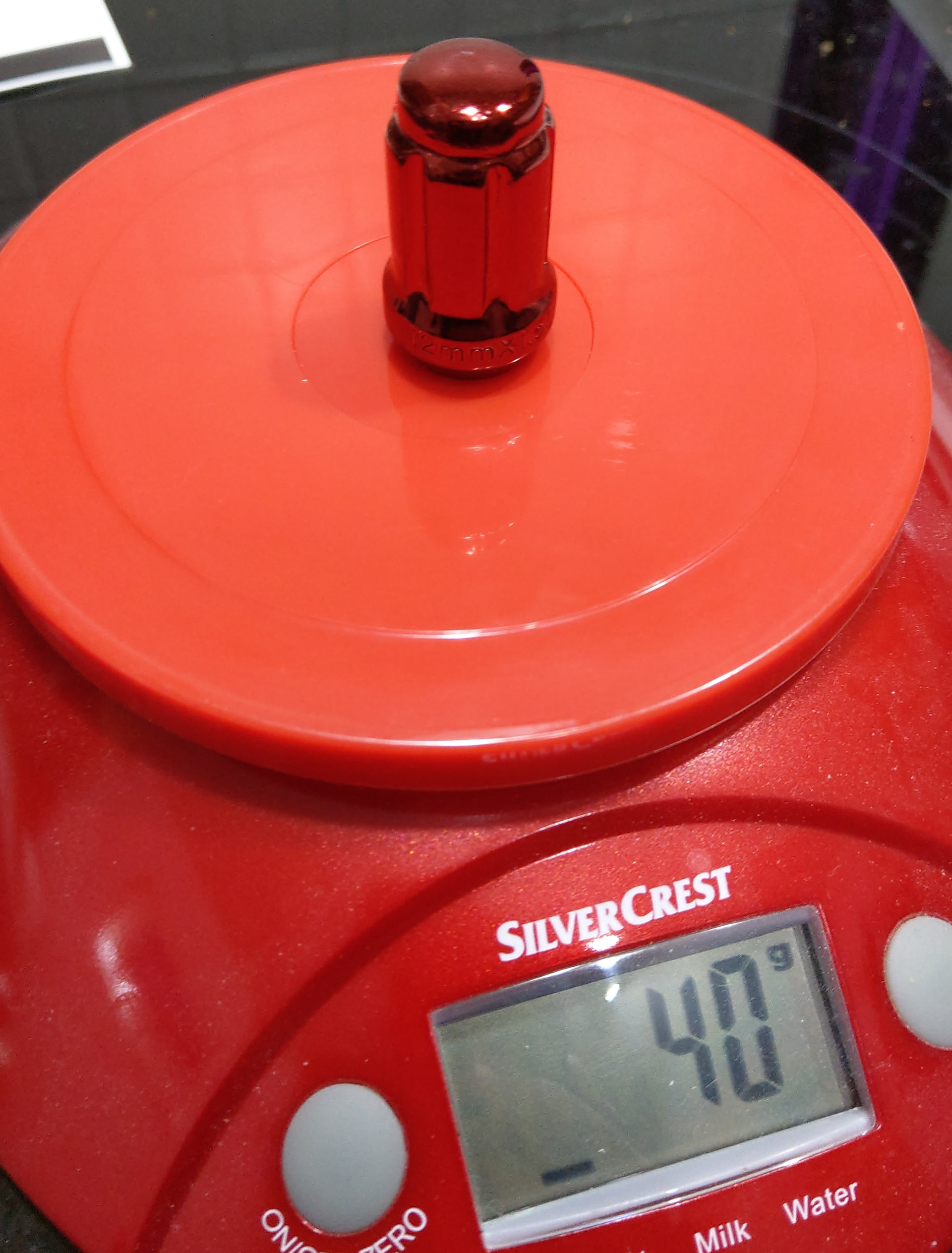

Wheel nut weights

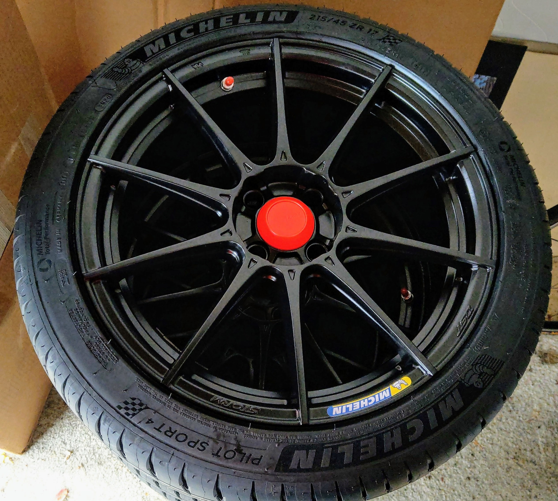

Advanti Storm wheels 6kg, 3kg less than Recaro wheels (9 kg)
Offset sightly (in this case) by the non OEM tyre size. All things being equal, a 215/45/17 tyre of the same tyre (PS4) will be heavier than a 205/45/17 one.
Edit: I do like those wheels actually. Very nice looking. However, I’d go OEM, with OEM center caps.
It depends on the tyre, if you look at the list above the 215 tyre is lighter than the 205!!
So a 215/45/17 PS4, say, ‘could’ be lighter than a 205/45/17 PS4?
Actually they are virtually the same weight
Virtually as in not equal?
difference of a couple slices of bread… if you want to be picky
(lololol :smiley: )
Well quite frankly I couldn’t give a flying fig leaf if 205s weighed less as I’d never fit them. Replaced the crappy Bridgestones after buying the car in Jul ‘16 with 215s grippier Michelin’s as they are a better fit for a 7” rim, sitting right in the middle of the fitment range. 215’s provide better rim protection (but that does depend on the make), makes the speedo a bit more accurate and a bit better on the bumps and a bit cheaper.
Which of course is a valid argument. However, I merely stated, after you compared the weight of your non-OEM alloys to the Sport Recaro alloys, that one really should consider the weight of a tyre too, to form a more complete picture, as, after all, it’s unlikely one would drive around with bare alloys with no tyres on them.
Your arguments to why you chose 215 as opposed to 205, and why you replaced the excellent OEM Brisgestones with alternative tyres is of course again a valid viewpoint, but another issue.
