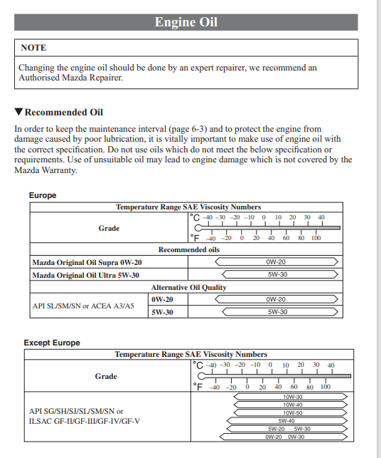

I too am finding the engine oil grade choice somewhat confusion, especially the choice between 0W 20 and 5W 30 fully synthetic oil grades, both of which seem to be recommended in the owners manual. The owners manual shows the choice as below:
From what I have gleaned, the 0W-20 grade is better for cold starting in colder climates than the 5W-30 grade as it has a lower viscosity at lower temperatures and is easier to get moving around the engine. However in the UK we rarely get anywhere the low temperature limits of -30deg C shown for the 5W-30 grade so this oil grade should be fine in the UK.
Regarding the viscosity rating for high temperatures i.e. when the engine is at operating temperature both grades are rated up to approximately 120deg C this probably being the upper temp limit for the oils before they break down. However the 5W-30grade will have a higher viscosity at higher temperatures than the 0W-20grade therefore protecting the engine more at these temperatures and possibly providing a quieter running engine but at the expense of creating more pumping losses, reducing power/fuel consumption.
What is also interesting, is that the table shown for “Except Europe” seems to show a plethora of recommended grades. Maybe, there is more to it than just operating temperature ranges such as different testing and specification regimes or even emission standards. If anybody can provide any sort of illumination on this point please do so?
Another online manual states as shown below:
This suggests that the correct oil grade for non USA, Canada and Puerto Rico cars i.e. the UK (and rest of the world) is the 5W-30 grade. The reasons for this are unclear as surely Scandinavia and other parts of the world get as cold as the USA and Canada. I don’t know where Puerto Rico comes into it as I wouldn’t have thought that it would get particularly cold there!
This does look to be suggesting that in the choice between 0W-20 and 5W-30, than the latter may be the slightly more preferential choice here in the UK but if anybody has evidence to the contrary please let it be known.
