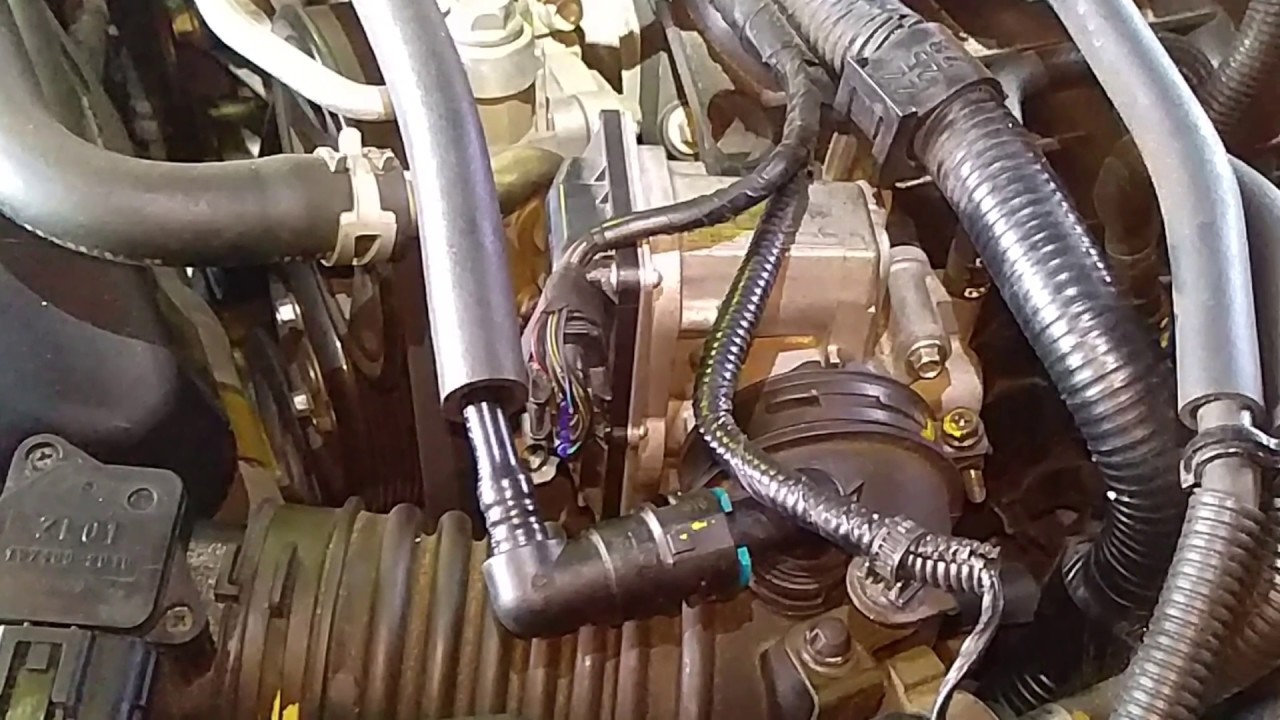

If you search the forum using the search function using something like NC thermostat change it’ll give you an idea what’s involved.
The thermostat is housed under the intake side of the engine, associated hoses and throttle body needs removing to gain access. Flush the system out with deionised water before filling with fresh coolant👍
