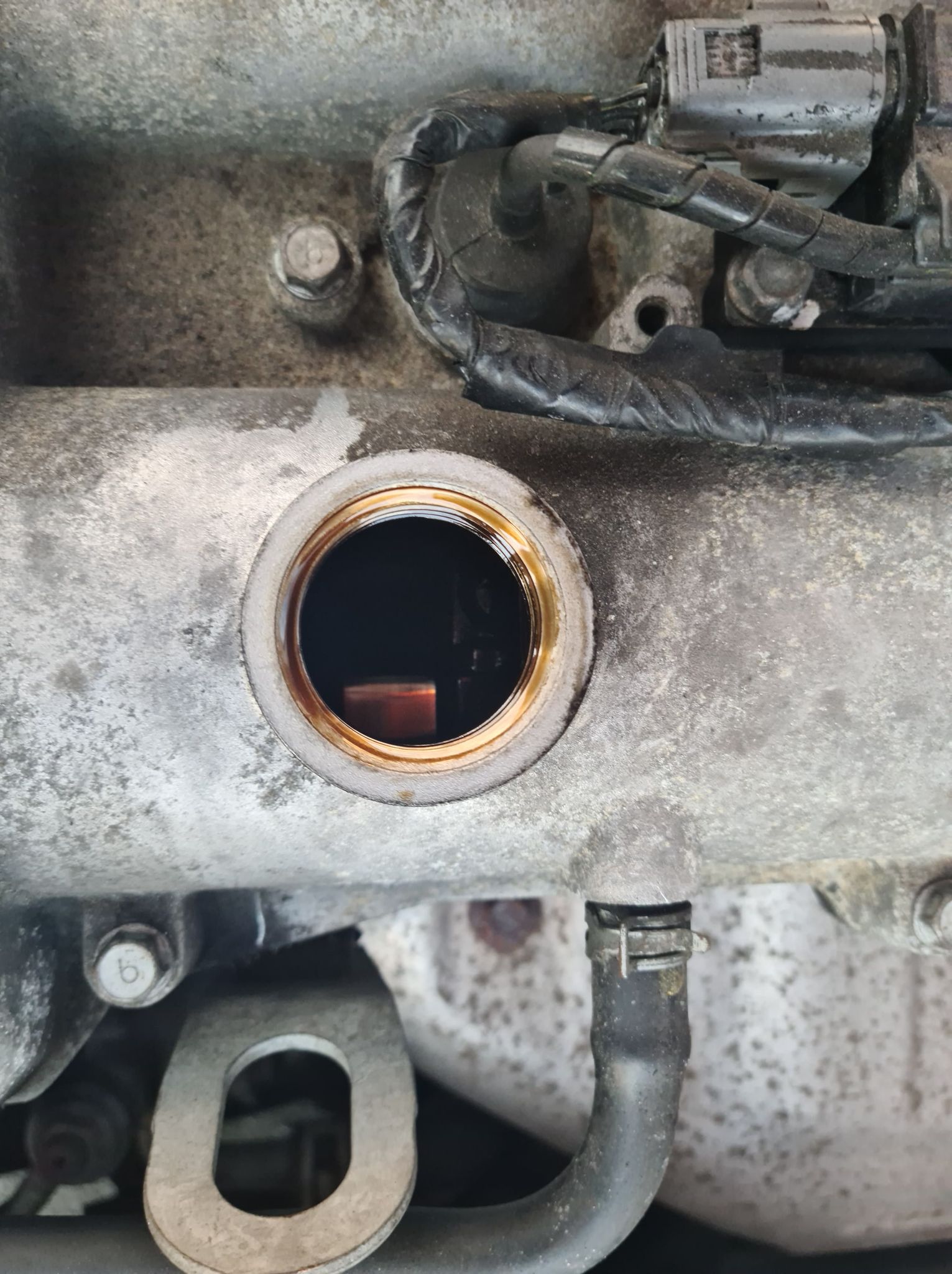

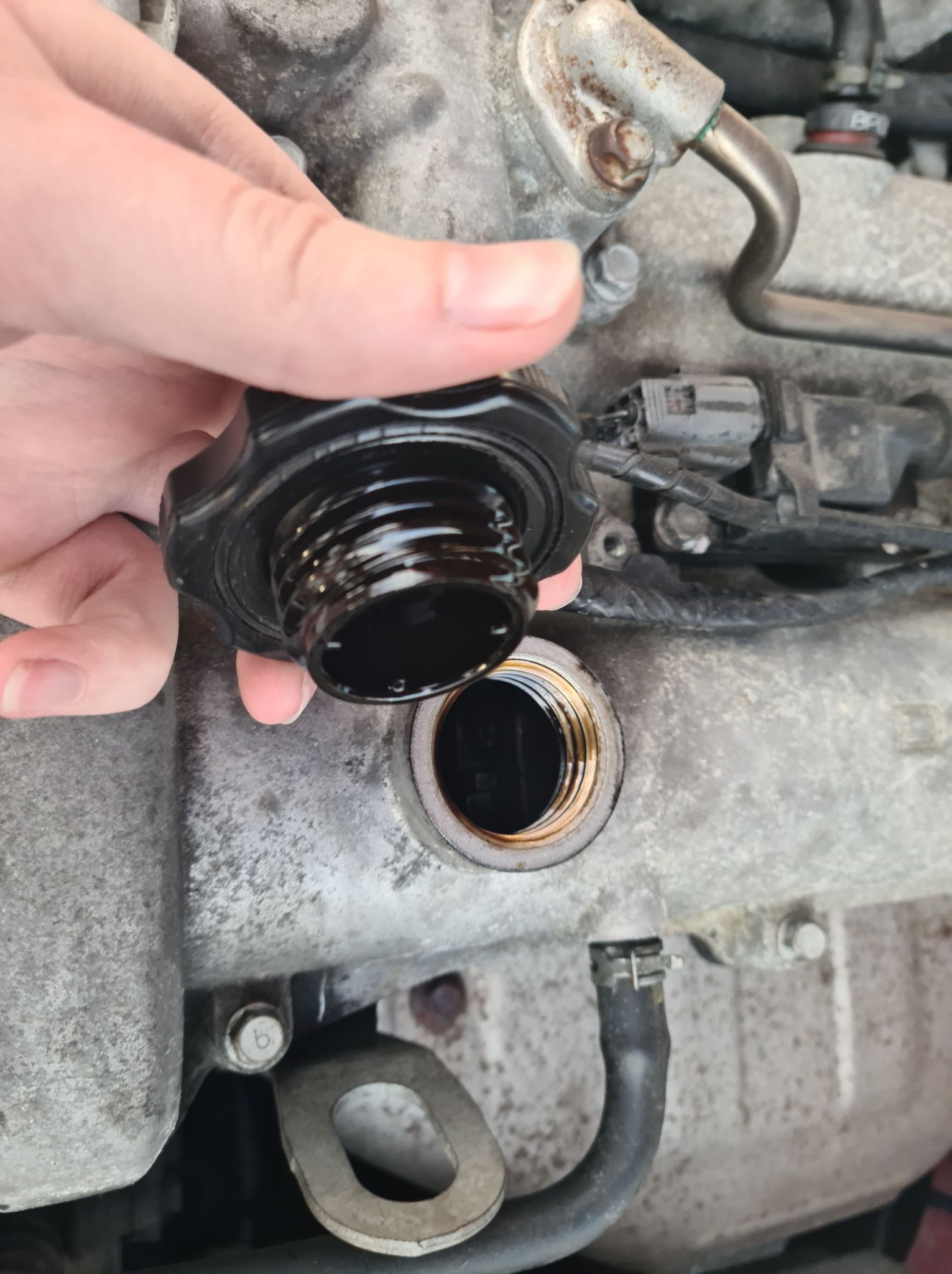

It’s probably handy to note that I didn’t notice any change in power etc. However I am about to check my oil for emulsion or mayo as they call it.

I check the oil and it looks fine just now. I have a feeling it’s the first pipe going into the radiator itself, as the radiator still seem full.
