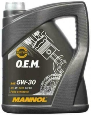

So 7 years later, I am asking myself this question and figure it might help someone to share my conclusion. My owner’s handbook (for a '56 plate 2.0 litre) specifies oil complying with ACEA A3/A5.
Cheapest fully synthetic I can find today for this is Mannol, a reputable brand, £18.99 for 5 litres on ebay:
This Mannol product also complies with Ford specification WSS M2 C913, which makes sense to me given that the NC engine is said to have been co-developed with the Ford Duratec equivalents. Previously I’ve used ACEA A3/A5 and WSS M2 C913 compliant variants of Mobil Super 3000, Castrol Magnatec, and even Ford own-brand.
I use mannol as a flushing oil, you can buy 20l drums of it off Ebay for around £50. I then drain and fill with 5w30 mobil1 as my service oil, but when it comes to oil changes I’m a bit ocd.
That seems to be an ok spec for the NC. Personally I’ve never heard of Mannol, I have now, been around for quite some time, Google says Germany supplier.
