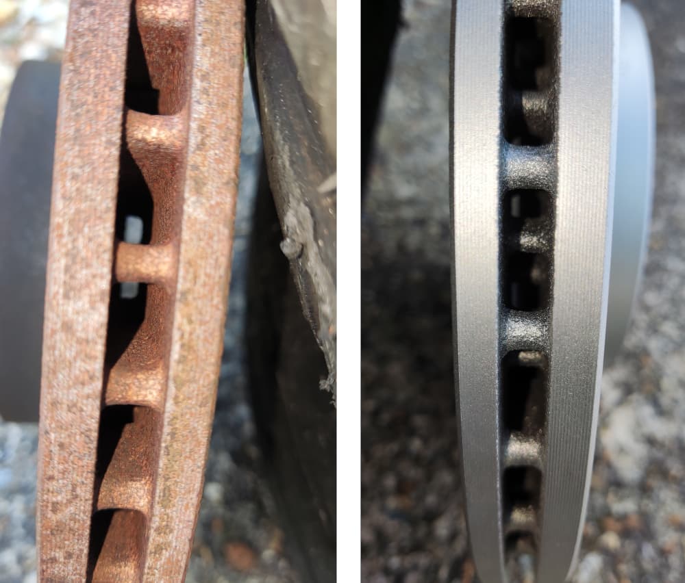

I ended up with TMD Pagid discs. One interesting thing is the two plates on the original disc are joined by closely spaced vanes(?) towards the circumference of the disc, whereas the pagids aren’t:

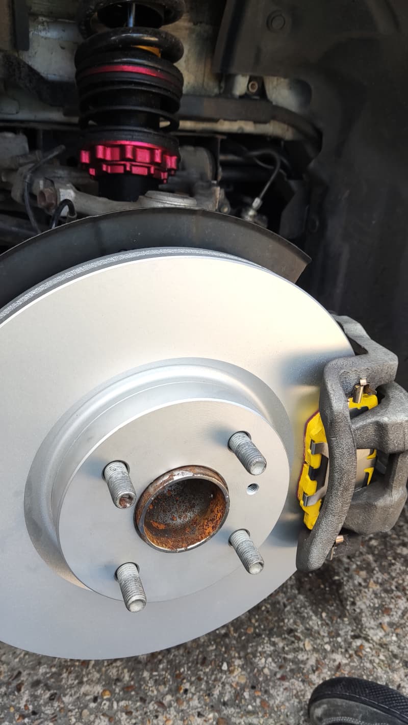

Also fitted some EBC Yellow Stuff pads on the front. I’ll see how they perform at the Nurburgring in a couple of weeks. I don’t think I’ll have the winmax pads in time.

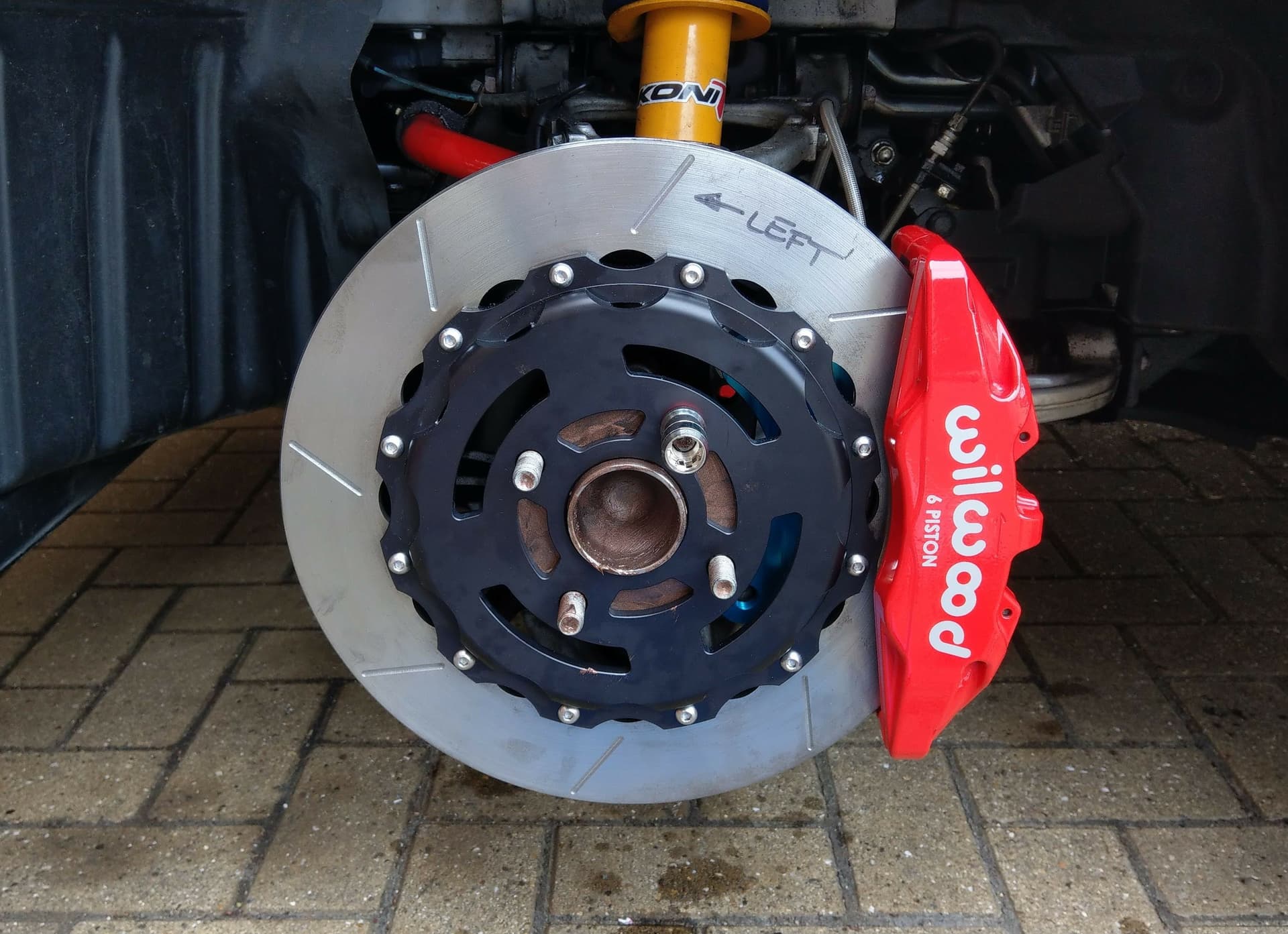

I occasionally take mine on track and fitted bigger discs with Wilwood calipers. No problems so far.
Ooohhh shiny shiny. I want some.
@BlueAgave what diameter are the discs? What size wheels are you running?
The discs are 12.88 " (available from Goodwin Racing) and wheels are 17".
