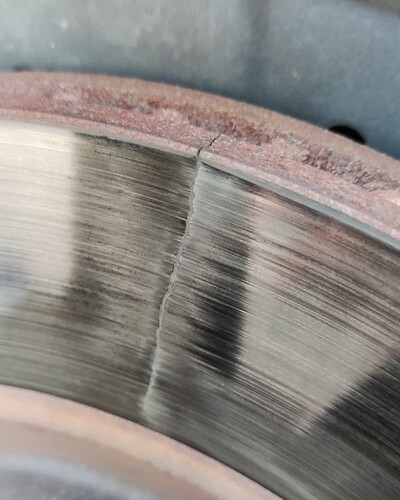

I had some minor brake judder driving home after Cadwell Park at the weekend. I thought it would take me a while to identify which disc it was coming from, but I think this is quite obvious
Not good. Lucky it didn’t let go, as it could’ve been nasty.
Check the other one as well. It might be wise to replace both👍🏻
Wise? I would say a must.
My keyboard jockey skills let me down!
I agree…….Must👍🏻

Discs, pads and fluid are all stock
I’m getting through front pads at an alarming rate on track. I’ve got some Winmax pads on order.
I was getting bad pad fade on track at Cadwell Park on Saturday, but no sign of the fluid overheating. Once I change to better pads, my fluid will start running hotter.
I’m using the car on the Nordschleife (easier on brakes I suspect) the week after Easter and I’m not sure I’ll have the Winmax pads by then, so I need to find something readily available as a stop-gap. Perhaps Roddisons or EBC yellow stuff.
WRT changing single vs. both discs, I’ll be changing both.
The problem will be when I find the visually undamaged spare disc at the back of my garage in 10 years time when I’m looking for another one
I better label it carefully or dispose of both.
